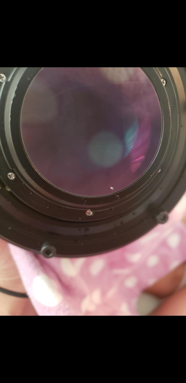

  1. Does anyone know how I can get this scratch out of the back of my inon uwl h100 lens.
    Super bummed... I can see it and I'm sure it will effect future photos. Thanks
  2. It is possible to remove lens scratches with cerium oxide powder in water and a drill-mounted rotary pad.
    However, the polish will remove the lens coating plus a minute amount of optical glass.
    If it was my lens, I would first contact the dealer or Inon directly, maybe they can replace or repair the lens.
  3. Hi,
    you can try to find the same lens, with a front element problem, and make one out of two...
    Have done that with the Inon 165 fisheye lens.
    Regards,
    Wolgang
