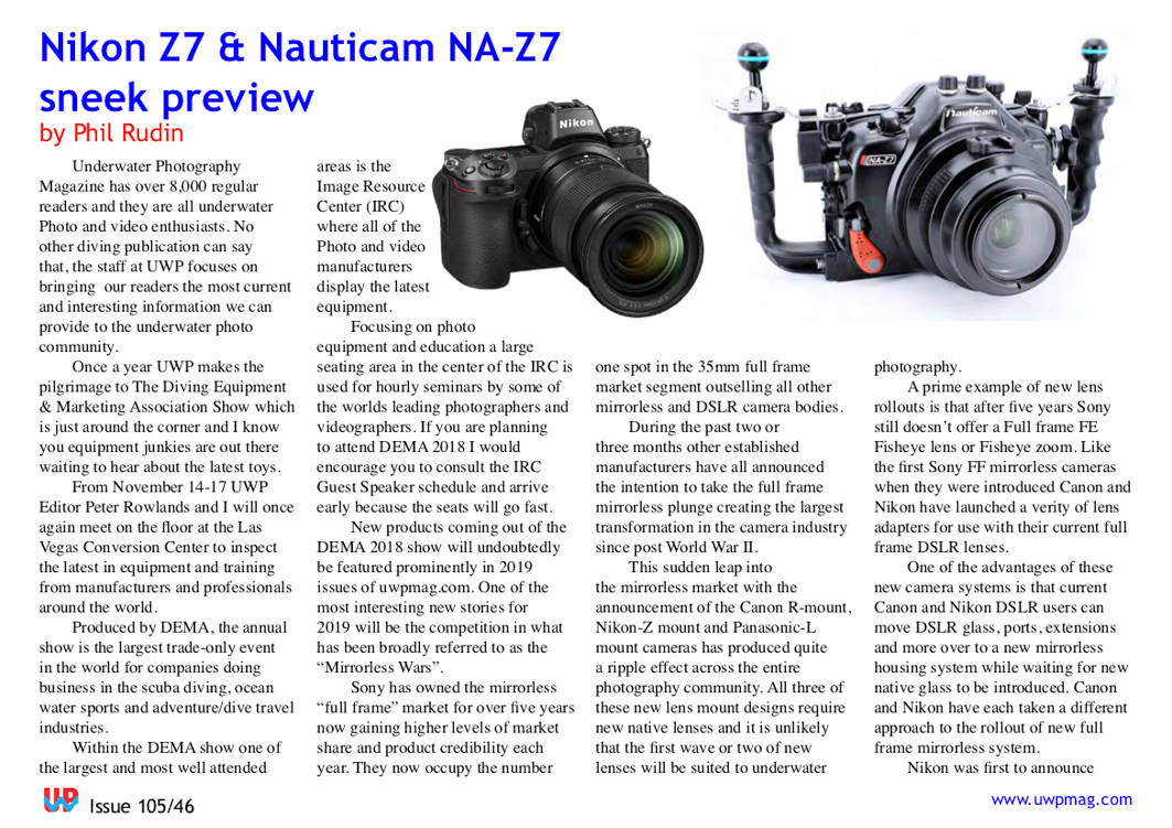

    I had an opportunity to use the MWL-1 with the new Nauticam NA-Z7 housing and Nikon Z7 camera two weeks ago. The system was outfitted with the Nikon 60mm macro for DSLR's and the Nauticam SMC-2. The lens ships with a neoprene dome cover and my test unit had the Nauticam dual flip adapter. My test unit did not have a buoyancy collar and I used float arms which seemed to offset any imbalance. The Nikon Z7 has the same growing pains found with the first generations of the Sony A7 cameras and other mirrorless offerings. Build quality of this camera is superb the best of any mirrorless I have used so far, excellent weather resistance. I only had the system in the water for about two hours so hardly enough time for a full review. I did like the idea of being able to cover from 150 degrees AOV down to 4X in macro. Attached are MWL-1, 60 macro and 60 macro with SMC-2 photos.
    If you would like more information go to UWPMAG.com and download the latest free issue for my thoughts on this system.
    Edited by adamhanlon
  14. Some additional information on the Nauticam NA-Z7 housing with MWL-1 and SMC-2 can be found in the current issue of Underwater Photography Magazine. Go to uwpmag.com for your FREE PDF download.
