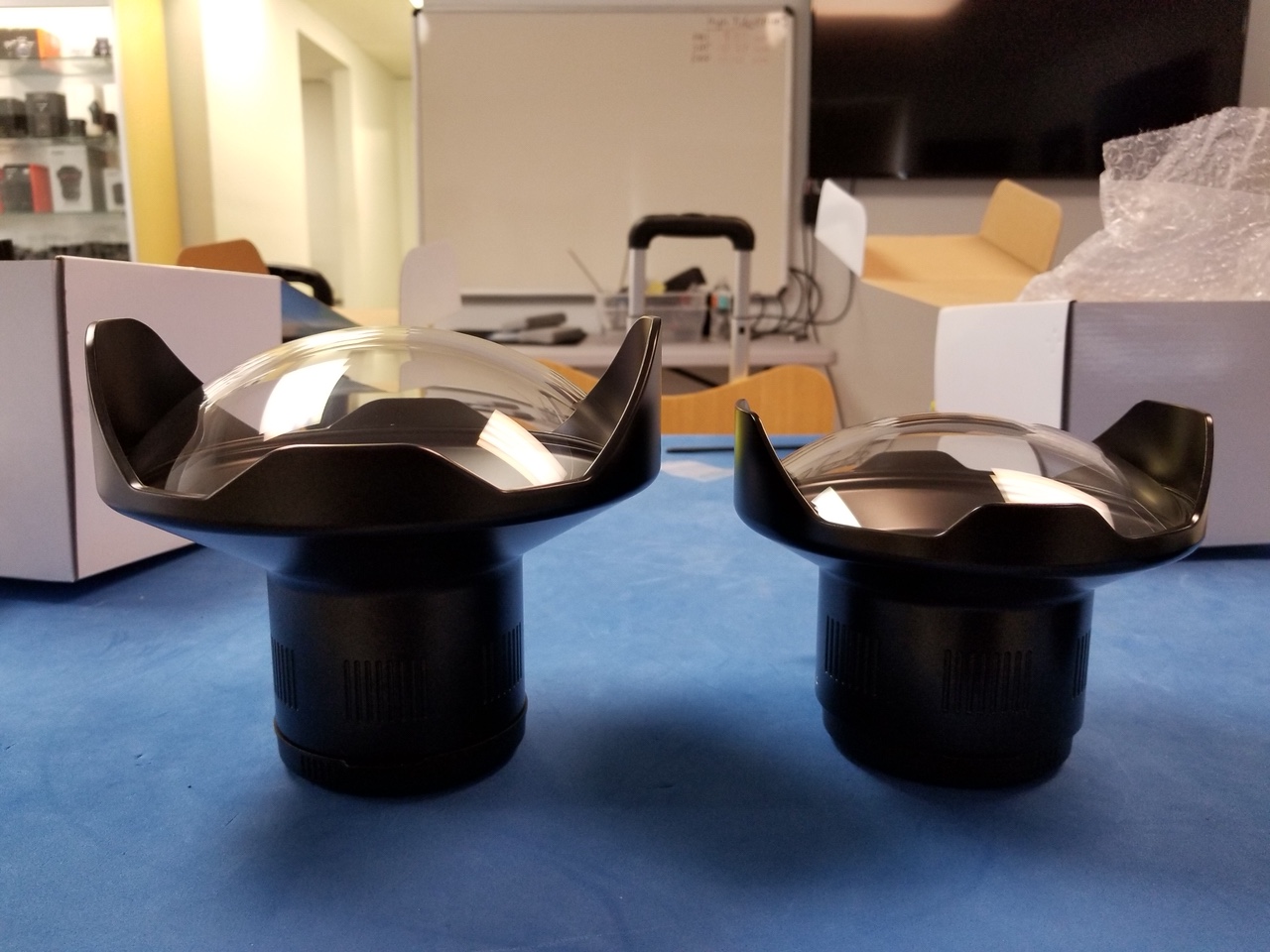

  13. Reef photo kindly offered to take a side by side
    From what I can see the 6 wide angle port is less curved this can still work fine with the 12-60 provided you find the ideal distance. The 7” port is 35mm longer so you need a 30mm extension
    The good news is I have both 6 dome and 30 extensions so will run some tests soon

    Quick update as expected the leica 12-60mm works fine with the 6” wide angle port. I have tried also the mini extension 30 the lens fits in it however am unsure the gear will because of the secure latch that holds the extension to the master port.
    I will post some shots when I have a minute to compare extension and straight port
    In terms of sharpness I took some shots at f/2.8 from what I see performance is more than satisfactory

    Interesting findings. Why would Nauticam recommend a 2mm shorter extension (67-65) for the longer Leica lens with the same 180mm (7) glass dome port? Does this make since?
  20. Interesting findings. Why would Nauticam recommend a 2mm shorter extension (67-65) for the longer Leica lens with the same 180mm (7) glass dome port? Does this make since?
    Sell more parts? Don’t really know 2mm are unlikely to make a substantial difference. Ergonomics maybe? How does it work for you?
    On paper considering the port is the same it doesn’t matter.
    Likewise for the 6” wide angle port it works anyway and is more compact than the 7”. Will you see a difference between them with the 12-60mm? I don’t think so. 12mm is not that wide and Nauticam is happy to recommend 3.5” wide angle ports with extensions for other olympus 12mm lens. Port size has to do with focus distance and all those lenses focus pretty close so don’t need large domes
