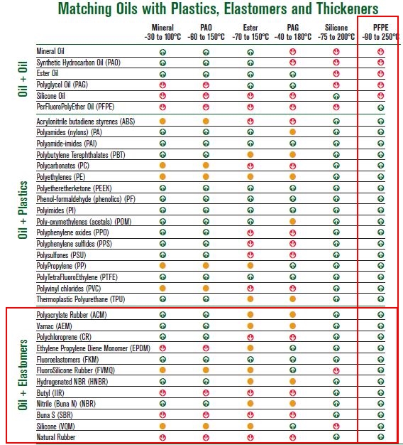

  12. I previously posted this in this thread http://wetpixel.com/forums/index.php?showtopic=55873&p=392858 about O ring grease compatability:
    This is an extract from a table for matching various oils and grease with materials. The Elastomer section shows that the PFPE grease is the only one that is compatible (indicated by green arrow pointing up) with all elastomers listed. If you want to use only one grease for your O rings PFPE greases such as Christolube, Tribolube, Krytox, etc are the way to go.
