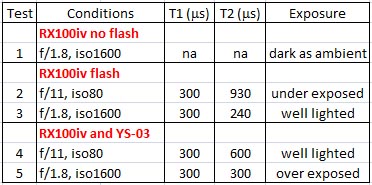

    I've been using two camera systems: Meikon a7RII case with ST-100 strobe (wired connection) and RX100iv in Fantasea case with YS-03 strobe (fiberoptic connection). I've taken these setups to the Red Sea, Cozumel, and Palau/Yap and have gotten mixed results for wide angle and macro. To find out more, I've tested both on a bench with oscilloscope and photodiode to determine pulselength for various conditions.
    The Meikon/ST100, wired, works only in manual mode and the ev controller does control output. For ev=-2 pulselength=365 microseconds, ev=0 pulselength=900 microseconds, and ev=+2 pulselength=2.8 milliseconds. Wired TTL with the Meikon 2-wire connection from the camera hot shoe does not work.
    The YS-03, fiberoptic TTL, works with some reservations. Results are shown in the table.
    The scene photo taken with the camera alone set for large aperture and high iso (test 1) gives a photo exposure that matches what is seen by eye. For the camera operated with its flash and set to low sensitivity (test 2) the photo is underexposed apparently because the on-camera flash does not have sufficient output. At high sensitivity (test 3), the on-board flash does a good job of lighting the scene. With the YS-03 and the camera set for low sensitivity (test 4) the exposing pulse is relatively long (600 microseconds) and the scene is well lit. TTL works well. At high sensitivity (test 5), although the camera should detect that the scene will be over exposed, the strobe still fires with its minimum pulselength and does indeed overexpose the scene. Apparently, the camera can't interrupt the second exposing pulse even thought it's not needed. Of course, in real life, I would use much higher f/number and lower iso, so amount of overexposure would be reduced.
