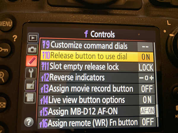

  3. The single best thing any Nikon user (regardless of housing brand) that plans to use their camera underwater can do is to set the "Release Button to use dial" setting in the Controls section of the Custom Menu to "ON".
    This allows one-handed adjustment of many camera settings, including ISO. How people cope without enabling this is beyond me :)
  4. I did that like I said, altough I prefer setting it to OFF (sometimes you want to change ISO and then Shutter Speed and you forget to press the shutter and you continue to change ISO instead) .
    But even with this setting ON I still have to go with my finger to the ISO button and then scroll the rear command dial with the same finger. And I find impossible to leave my finger near the ISO button and it's in a position that is not easily acessible. Like I said ISO is my most changed setting usually so I'm finding this solution very cumbersome. I wanted to use FN2 + rear command dial to control ISO, as I can do it on the fly, without taking my eyes from the viewfinder.
  5. Just try the "Release Button to use dial" and after a few dives you will get use to it.
    If I want to change the speed, i just hit the back lock focus after the iso button.

  8. The NA-D850 has a lever for ISO control activation under your right forefinger as I remember? As far as I know, there is no button to press?
    With the "Release Button to use dial"setting on:
    Push the lever with your forefinger
    Adjust the ISO with the sub-command dial with your thumb
    Push the lever again to revert the control.
    I have no idea how people manage to do it without the setting!
    I think the issue you are experiencing is more to do with muscle memory and learning than housing ergonomics!

  10. Here is an easy way to adjust the ISO and other settings on the Nikon D-500 and new D-series cameras:
    http://wetpixel.com/forums/index.php?showtopic=63404.
    In brief:
    Turn camera On > Menu > Custom Settings Menu > f6 "Release button to use dial", set to On.
    Exit to main screen.
    Press the info button, then the setting button (ISO for example), and follow the menu that pops up. Use one of the two control dials to change the settings. Press info to exit, or another control button to change its settings.
    Done.
