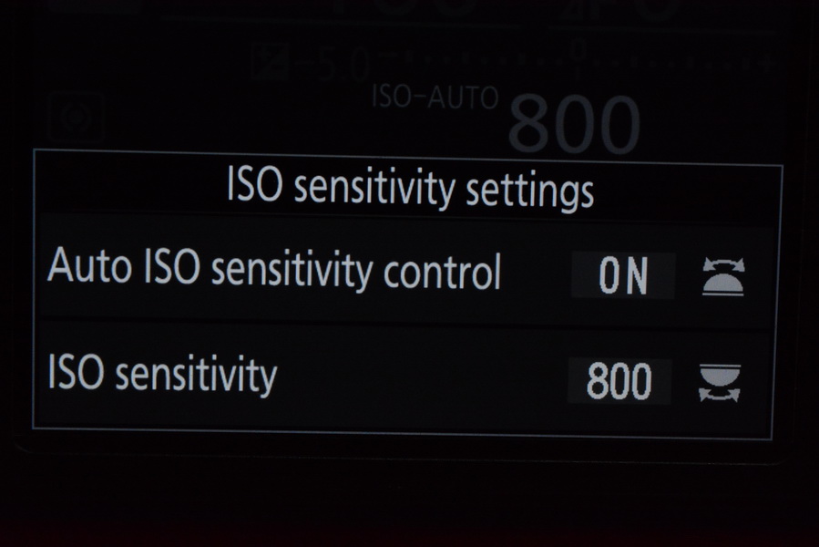

    ISO sensitivity setting: Press the info button, then the ISO button. An ISO menu appears, the sub command dial turns the ISO function on or off; the Main command dial sets the ISO value.
    To exit, press info again, or press the shutter release half way.

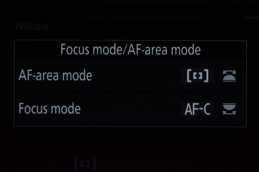

    Focus Point setting: Set the Focus mode lever (front of camera, lower left) to AF. Now, press info, then the AF-mode button to show a Menu to set the AF-area mode/Focus mode.
    Turn the main command dial for continuous AF-C or for single AF-S.
    The sub-command dial (top right front) sets the focus area to Single, Auto area AF, Group area AF with 25, 72, 153, and 3D tracking. Exit by pressing the info button.

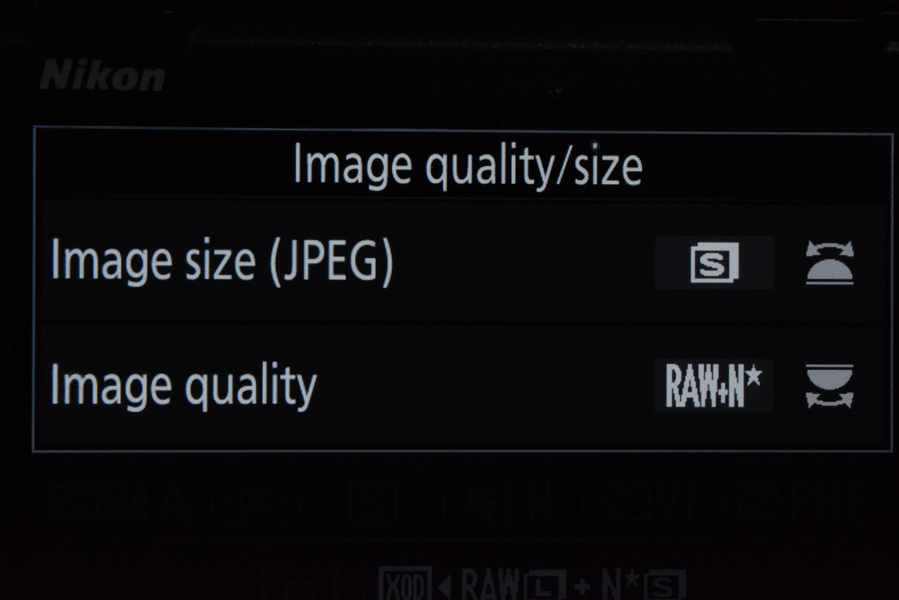

    Qual button: Image quality/size.

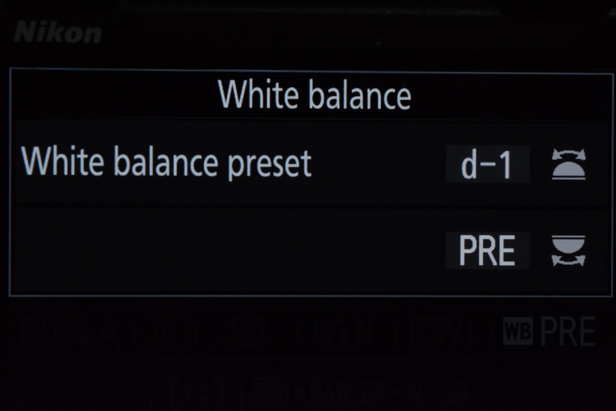

    WB button: White balance preset (d1 -d6) /color temp PRE, K and color grid.

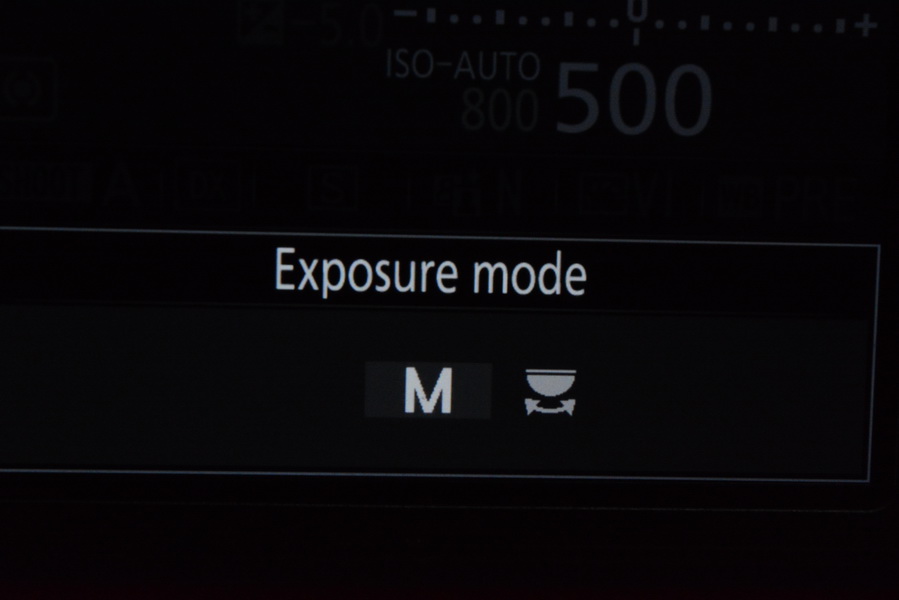

    Mode button: Exposure mode P,M,A,S.

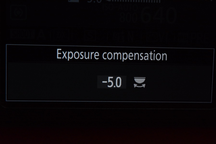

    +/- button (Exposure compensation): Sets the main control dial from +5.0 to -5.0.
