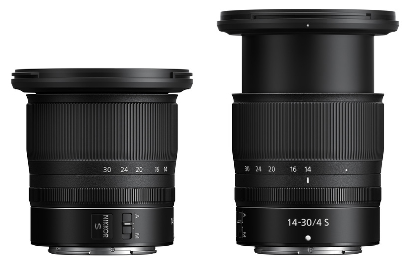

  14. What bothers me with the Nikon's new Z series cameras is lens choices or lack of them for use in a underwater housing. For wide angle, you either have to go with the adaptor to use existing Nikon F mount lenses or go with their new 14-30mm lens, which may present a problem behind a dome after looking how far the front element moves when you go 14mm.
  15. What bothers me with the Nikon's new Z series cameras is lens choices or lack of them for use in a underwater housing. For wide angle, you either have to go with the adaptor to use existing Nikon F mount lenses or go with their new 14-30mm lens, which may present a problem behind a dome after looking how far the front element moves when you go 14mm.
    This lens is collapsible like the 24-70 kit lens and some vintage Leica lenses. The photo on the left shows the lens in the collapsed state - zoom ring lined up with the dot to the right of "14" seen in the photo on the right. One cannot take a photo with the lens collapsed (reminder message shows up if ones tries). This difference in length is thus unimportant as to fitting behind a dome. It is useful for taking up reduced space when stored, which might be important for dive travel. What is unknown to me, however, is how much length changes when zooming actual focal lengths. I have not looked at all the on-line videos to find out. Many lenses in this zoom range do not change all that much in length.
