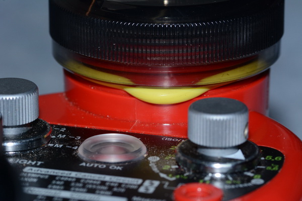

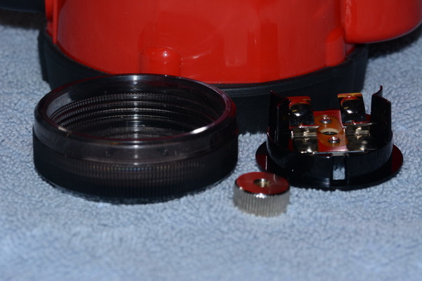

    Inon Strobes have a double cap, an external female cap that seals out the water and an internal one with spring contacts and a screw nut to secure the batteries. Leaks arise when the edge of the cap as it is being screwed down twists part of the O-ring and allows water into the battery compartment.
    The solution is to keep the O ring lightly lubricated, in a pinch even saliva will do. To prevent leaks, it is very important that one look all around the O-ring each and every time the cap is screwed on.
    The inner Inon battery cap (and Sea&Sea cap) has metal spring terminals to interconnect the batteries. To prevent corrosion, after diving in salt water they need to be rinsed in fresh water, dried and lubricated.
    The screw nut for the inner cap is a nuisance to screw on, and is easy to misplace or drop. Packing a spare screw nut is not a bad idea, and if lost, it can be replaced with a wad of paper or a short length of plastic tube, say cut from a ball point pen or Tygon tubing, so the outer cap compresses the inner cap to contact the batteries firmly.

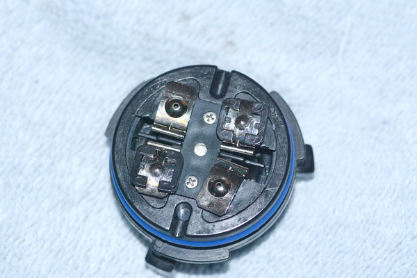

    The cap's O-ring requires minimal silicone lubrication. However, the caps electrodes which connect the batteries two by two can bend out of alignment, as shown here by the bent lower right contact.

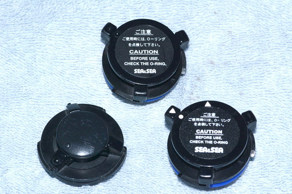

    Sea&Sea has improved the design of their cap over the years, and fortunately the old and new styles are interchangeable.
    Photo of old and new Sea&Sea strobe battery caps, Sub-50 TTL on left, YS-110 middle and YS-D2 on right.

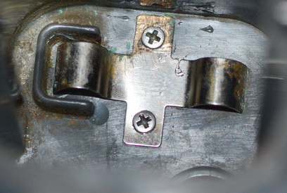

    The battery compartment itself is quite similar in both strobe makes. Troubles such as poor contact, strobe not turning on or intermittent power failure arise from corroded battery contacts at the compartment's bottom where there are three battery contacts; the one shown below links two of the four batteries.
    If it corrodes, it can be removed to be polished; the screws do not go through the plastic case.

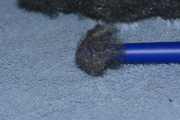

    The two other contacts are sunk into the compartments body and cannot be removed; when corroded, they can be polished by attaching a piece of fine steel wool to the end of a thin rod, pencil or a pen, and rotating it.

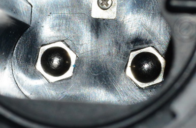

    The hexagonal head screws at the bottom connect to the electronic compartment. As they are not sealed, once water enters the battery compartment it can flood the electronic compartment by leaking around these screws. It is most desirable for the strobe manufacturers to seal these screws, such as with O-rings, so they are water proof.
    The Sea&Sea and Inon battery contacts that connect to the electronics are recessed and have small gaps around them, visible here at each of six corners, which allow water to enter the electronic compartment.

  3. Personally I prefer the INON arrangement, the little screw cap never sits outside the strobe for long and you can check batteries are in place and contacting prior to screwing on the o-ring cap. The O-ring in my view needs a generous amount of lubricant and a light smear on the cap as well, the cap screws on so much easier if you do that and the clear cap allows you to inspect the seal.

  4. I will add that the clear cap of the Inon makes it easy to check and see that the large yellow o ring is properly positioned after installation and Inon suggests screwing the cap on slowly to avoid pinching or twisting the O ring. Both my son and I have used inon strobes for about 10 years or so and neither of us has had a problem. I do replace the O rings from time to time and carry spares, but frankly, cannot recall having one appear to wear out or shred or disfigure. I am not sure, but they may last forever. When I have replaced them I have actually used the old ones for various purposes, including as a makeshift octo holder.

  13. I've had no problems with the Inon O-ring ever since I started lubing the inside lip of the cap. Just put a light coating of lube on the inside of the cap where it rubs against the O-ring. So if theres a spot on the O-ring that doesn't have lube, it won't catch against the cap.
