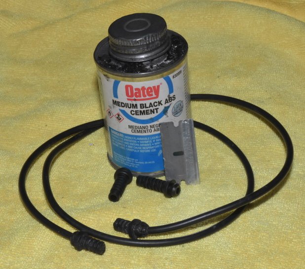

  10. In reply, for cable from eBay one can get Digital Fiber Optic Audio Cable, TosLink for TV DVD AMP,
    6 ft for $2.95 or 25 ft for $6.95.  The cable varies from 3 to 5 mm o.d..  To fit in the plug, the ends of the 5 mm cable are trimmed, like sharpening a pencil, with a sharp razor.
    For the plugs one can use:
    The plugs are about the right size to plug in the ports of the housing (i.e., Nauticam and Subal) and the Sea&Sea strobe..  To the end of the plug one can add a 1 x 5 mm i.d. O-ring, but I have not found this to be necessary.
    I cut the plug to a length of about 10-12 mm using a single edge razor.  If the plug to cable junction need to be secured, I glue it with rubber, or  plumbing ABS, cement.

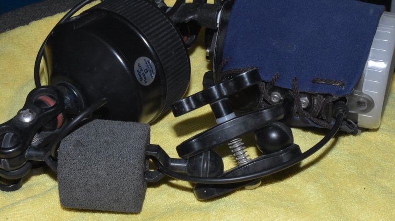

    To keep the cable from catching on outside objects, I wind it around the UL strobe float and through the holes in the UltraLight arms.
    (The strobe has a jacket made of scrap wet suit material and a shoe lace; it has worked well for several years to prevent minor damage.)
    I hope this answers your request, please let us know.

  12. One detail:  Commercial fiber optic cables are spring coiled, but putting the cable in boiling water to coil it tends to cut down the light transmission.  Instead I just thread the cable through the strobe arms to secure it.
    Happy Photos!
