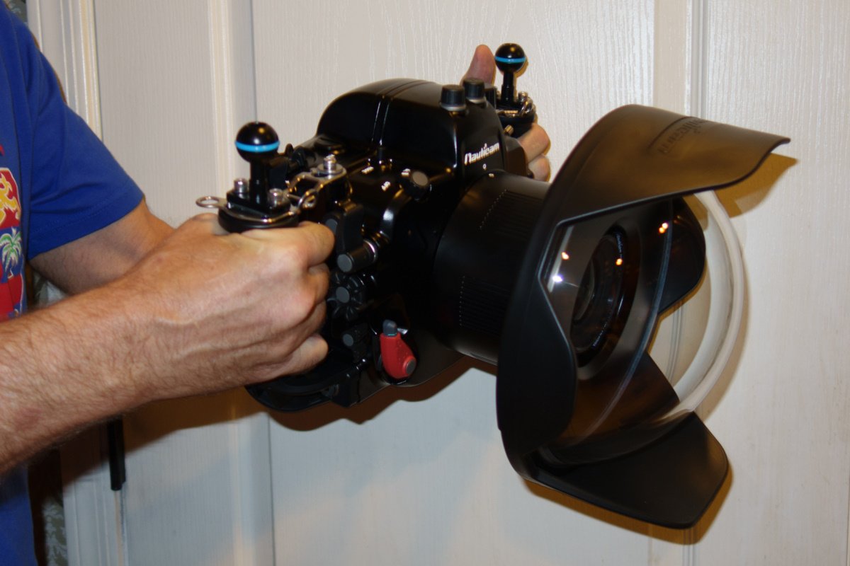

    Me perhaps even more.  I had never seen a 230mm dome port (or hardly any others either) before one showed up in my home as part of my first DSLR rig,   And I got this:
  5. I do sympathise.
    Crazy though it may sound, trying to travel with a 230 dome port put me off using a rectilinear lens. I switched to an FE - the Sigma 15mm initially and now the Nikkor 8-15. That plus a much shorter EXR and a 180 dome is so much easier for traveling- and hauling around for shore dives.
