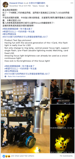

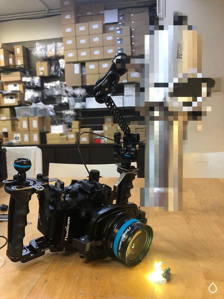

  10. The strobe by Backscatter is a good macro and snoot tool but it's not a powerful strobe. It's quite cheap at $500 ($550 after pre-orders) but you need another set of strobes if you want to do something besides macro/snooting so it's probably another $700-800 to cover all the lenses. The Retra PRO has wide angle power and a circular lamp while it seems to do a very good job at snooting too. It's more expensive but you only need a pair in your luggage which I personally appreciate.
    I found the facebook post (see screenshots below). It seems the pilot light on the Retra PRO is strong enough to get a slightly over exposed image at f10 ISO100. This means you will probably not have any issues with aiming!

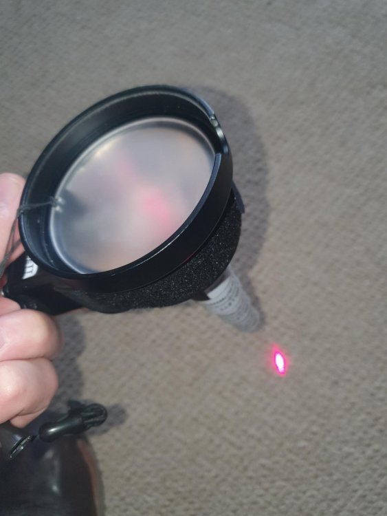

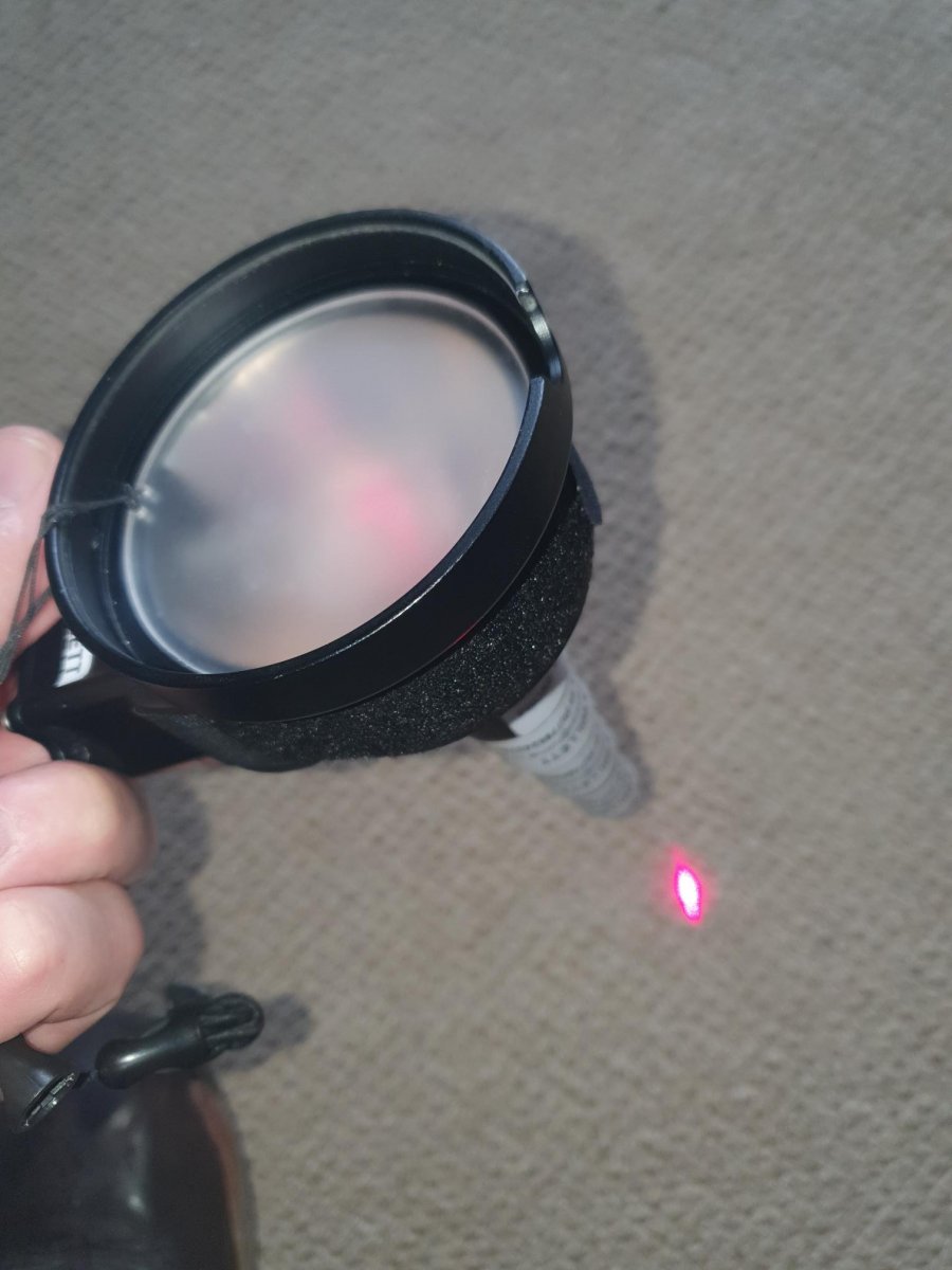

  19. Hi
    I use YSD1 and YSD2 using a 10 bar internal laser guided snoot. works fine for me.
  20. Oh, they changed the laser to be internal now? That's a good thing. Probably not available for my trusty YS-02 (not D2!)... I'll check them out.
