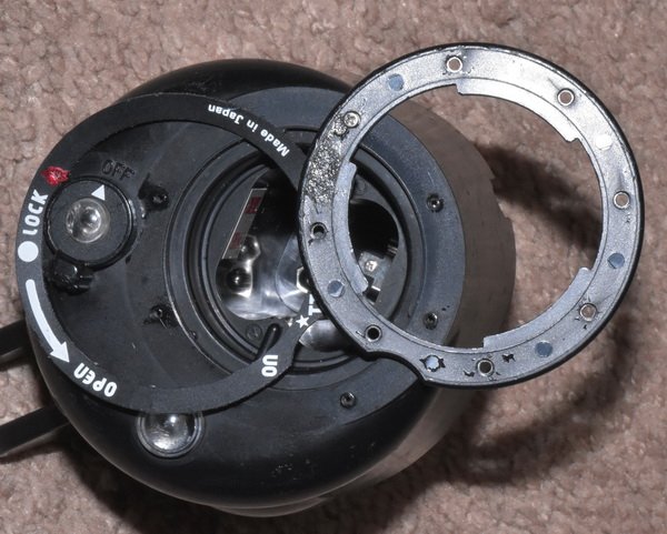

     Fig. 1. A thin printed plastic ring with 'Open, Lock, On, TTL' printed on it, is glued around the battery compartment opening. Under this label, eight small screws secure a plastic ring with three square tabs that lock closed the battery cover.
    The battery compartment has no battery dividers, no water sensor. At the bottom is a spring metal strip that connects in series two of the batteries, and two round head bolts with a hexagonal neck which pass through the compartment's bottom, each sealed by an O-ring and retained by washers and hex nuts, to  connect the four AA batteries via a red and black wire to the internal electronics.
    The battery cap is simpler than the current cap for the YS-110, -D1 and -D2 strobes, has 4 coil springs instead of the newer leaf springs to connect the four batteries in series, and no high pressure gas release vent.

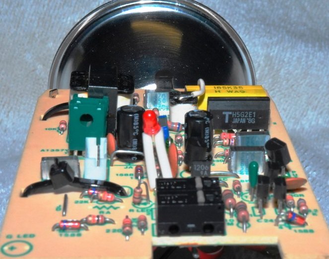

     The electronic board assembly is L-shaped, with a semicircular horizontal board (63 mm diam), connected edge to edge to a flat square board (63 x 95 mm). The horizontal board has the xenon flash tube and reflector, while the vertical board carries the electronic circuits to flash the xenon tube.
     The flash tube is U shaped and held within a tea cup shaped, circular paraboloid reflector; + and - wires are attached to each end and the bare copper trigger wire is connected to its middle.
     Fig 2. Circuit board of the YS-50 showing the clear labeling of the solid state components, the H5G2E1 thyristor is upper right, the two push button switches are the black boxes near the bottom center. The main capacitor is on the under side of this board. The nut and bolt construction allows one to open and reassemble the strobe with ease.

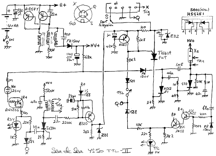

     On one surface of the vertical board is mounted a large photo flash capacitor, CE62P of 1100 uF and 330 V, the electronic components are mounted on its other surface. This design allows the observer to draw a diagram of the circuit (Fig 2). For the YS-50 and YS-60 strobes the circuit diagrams were published by D W Knight and Laszlo Kalmar in the Russian log 'Impulsite - Pulsed Light in Photography' (4).
    Fig 3.  Sea&Sea Yellow Sub 50 TTL-II electronic diagram, by Knight and Kalmar (4)

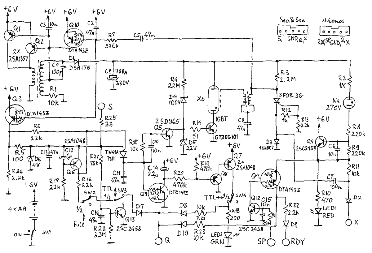

    Fig. 4.  Sea&Sea Yellow Sub 60 electronic diagram, by Laszlo Kalmar (4)
     Although no microcomputer is present, this and similar S&S strobes with TTL have a basic electronic circuit, based on the H5G2E1and similar thyristors (now obsolete) with timer capability, to process the TTL signal provided by the camera and translate it into a useful strobe flash.
     The camera's TTL pulses are sent via the sync cord to the strobe's electronics and H5G2E1 thyristor to control the flash's duration.
