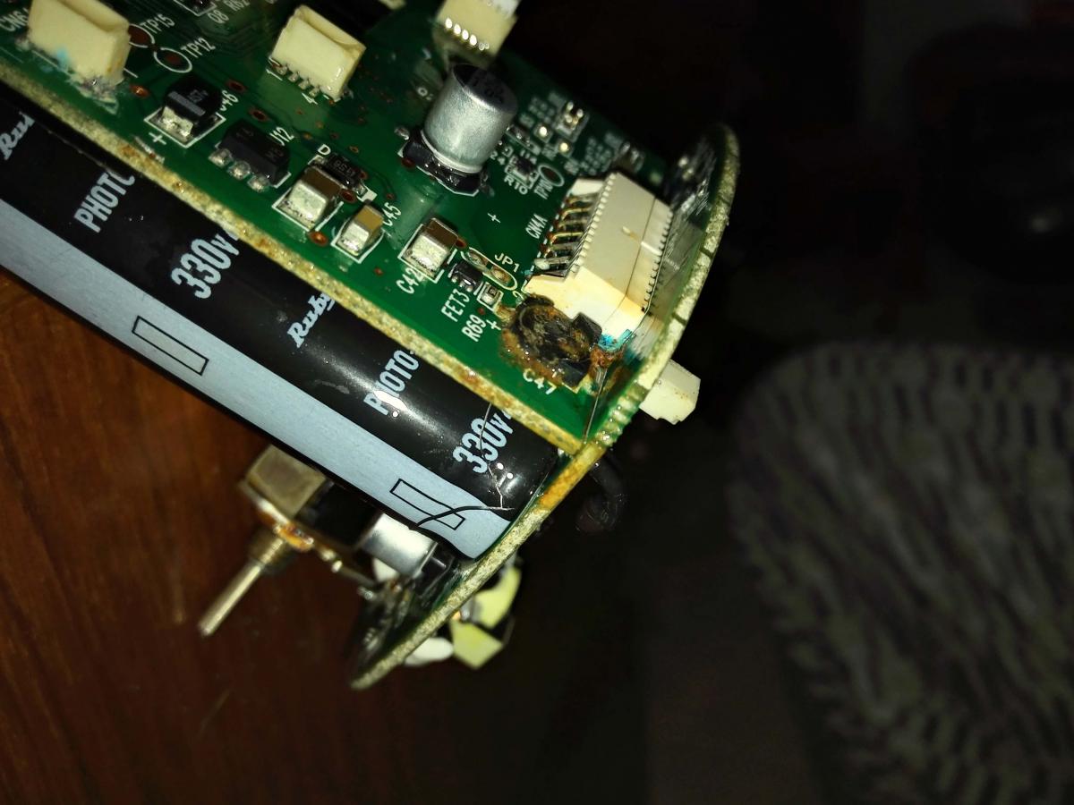

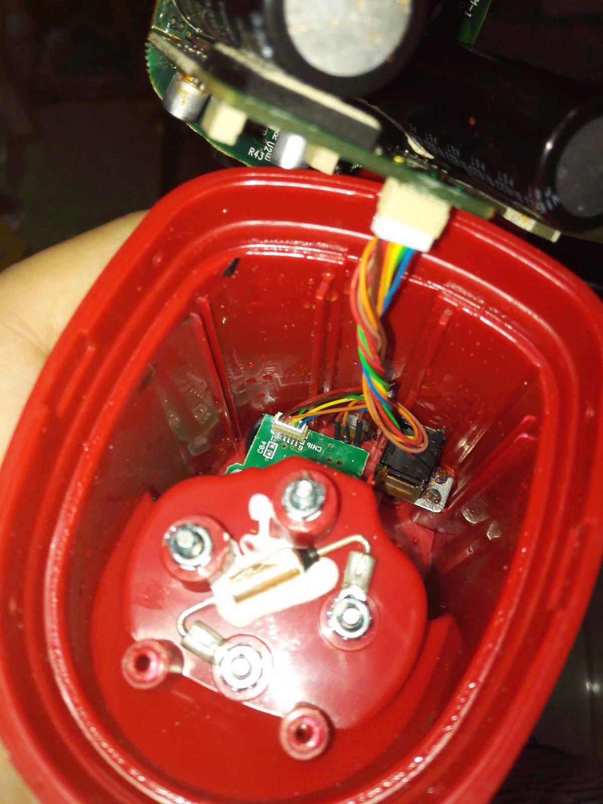

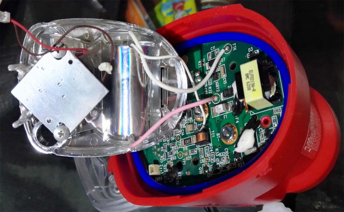

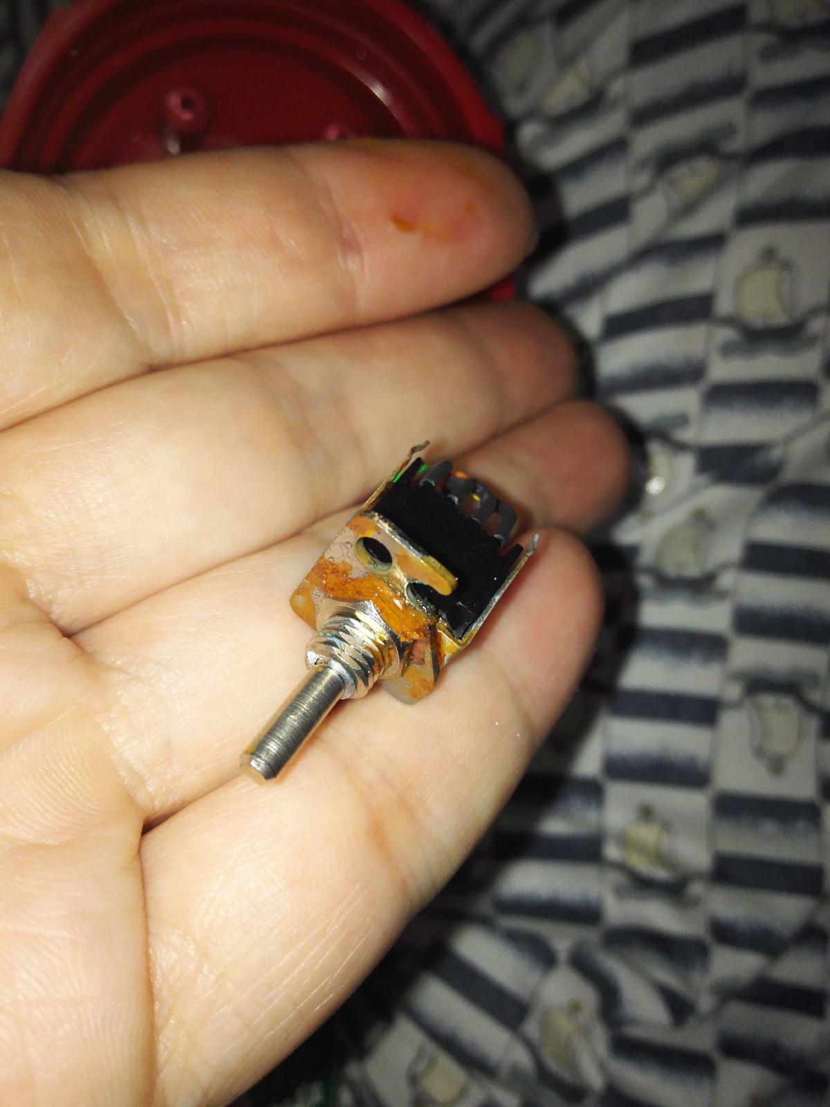

  12. This is a broken underwater strobe. I took it apart and found that there were only a few droplets in the housing. The droplets were salty. The potentiometer is seriously rusted, so the position of leakage is the knob to regulate power. Knobs turn potentiometers, but their axes are difficult to align. This will push the O-ring to one side, creating tiny gaps and slow leakage.
    Sea water also causes an electrolytic capacitor to be dissolved.

  19. This is a broken underwater strobe. I took it apart and found that there were only a few droplets in the housing. The droplets were salty. The potentiometer is seriously rusted, so the position of leakage is the knob to regulate power. Knobs turn potentiometers, but their axes are difficult to align. This will push the O-ring to one side, creating tiny gaps and slow leakage.
    Curious where you able to get a new potentiometer and fix this?
