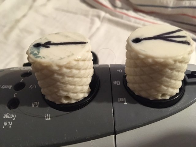

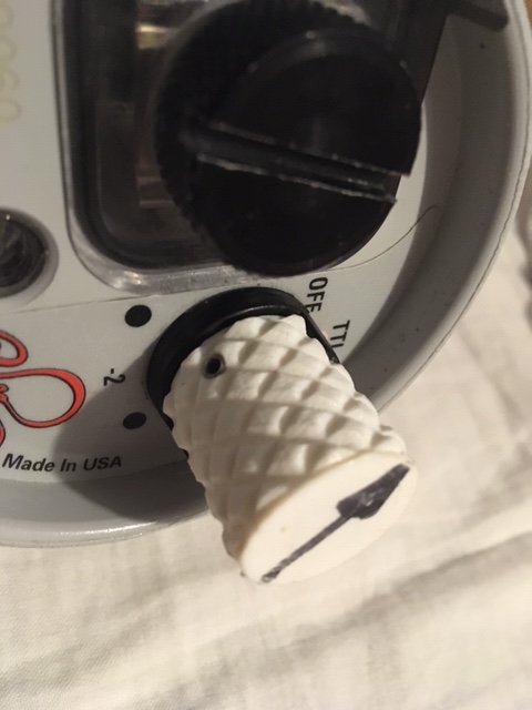

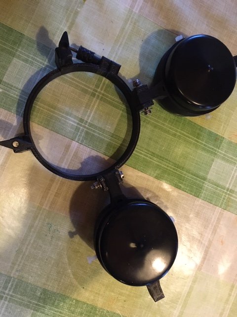

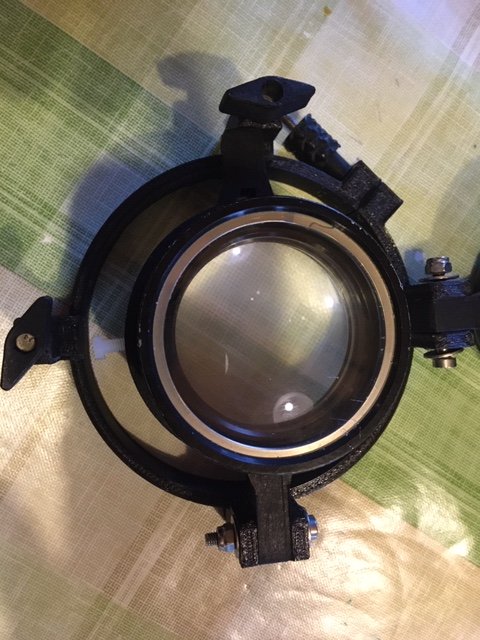

  7. yes... I have a 3D printed double flip adapter for Ikelite modular port that I drew and designed myself, a thingiverse snoot for Ikelite DS125 and self designed knob extensions for both the Ikelite DS51 and DS125 strobes.
    I used 3d hubs for printing. Then it was lots of hobbyists printing at home, but now  they dont use private printers any more. But there is a friend in Germany that has his own 3D printer (he printed  the snoot).
    I used freecad 3D, and lots of measuring. For the extension knobs, there was some sanding and thread cutting needed. They are fit with little allen screws.
