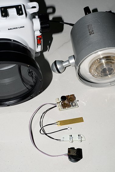

  14. Dear all!
    We tested the s-TURTLE SMART(SONY) and the i-TURTLE SMART(NIKON) with RETRA PRO in HSS mode.
    BTW  in TTL too!  :)
    The result was great!
    The Sony A7R2 1/8000. , The Sony A6000 1/4000 and the Nikon D7100 knows the 1/8000 shutter speed.
    We will make a blog in Our website soon how works the HSS and why need the Retra Pro to use it.
    Here is the links to the results:

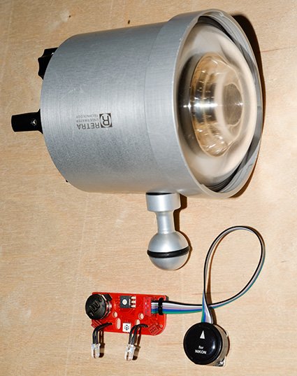

    UWTechnics #11031-HSS TTL board for Nikon is available now in online store:
    https://uwtechnics.com/index.php/online-store/ttl-converters/for-nikon/ttl-converter-for-nikon-nauticam-housings-detail
    New product firmware also includes updated TTL-profiles for Inon, Sea&Sea, Ikelite, Retra and Subtronic strobes. Available TTL boards for the following housings: Nauticam, Sea&Sea, Hugyfot, Seacam, Subal, Seafrogs (Meikon), Sealux, Aquatica.
    Today i tested this #11031-HSS board (for Nauticam) together with Retra Pro strobe at 1/8000 shutter speed, it worked fine.

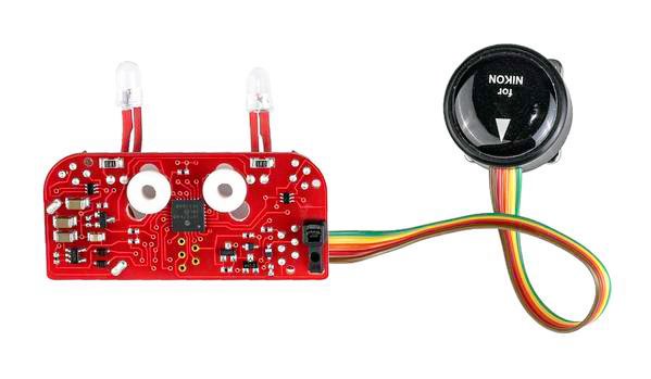

    Hardware is little bit different from previous boards. New HSS boards are much more powerful than previous, the LED output power is significantly increased.  Such optical power is necessary for Retra Pro optical TTL input. Also, the firmware is new, it includes Retra Pro TTL profile and HSS support module.
    By the way, new TTL-Converter for Nikon (#11031-HSS) got updated TTL profiles of all other strobes too (Inon, Sea&Sea, Ikelite, Subtronic, Retra). This is totally renewed improved firmware.

    According the TTL-Converter #11075-HSS firmware, -
    If user keeps camera system in TTL flash mode, then normal X-Sync speed limitation works automatically (1/250), as necessary for all underwater strobes mono-flash.
    When user set Manual mode in flash menu ("WL" command), the system performs normal manual flash in all range of casual shutter speeds (up to 1/250), but in high speeds range 1/320 ... 1/8000 it works as HSS pulsating flash with variable frequency and necessary timings.
    Pay attention, that HSS pulsating flash works only for Retra profile (TTL-Converter switch pos.-7), but for other uw strobes (other switch positions) at high shutter speeds the flash is simply Off automatically (but high speeds 1/320 ... 1/8000 are still available for shooting with ambient light).

    Yes, of course, it works the same way on all versions of UWTechnics HSS boards.
    If user chooses "Auto FP" in Nikon sync menu, it switches system to M mode automatically. When shutter speeds are in limit up to 1/250, it works by normal sync mono flash. If use 1/320-1/8000 high speeds, then system automatically switches to HSS mode.
