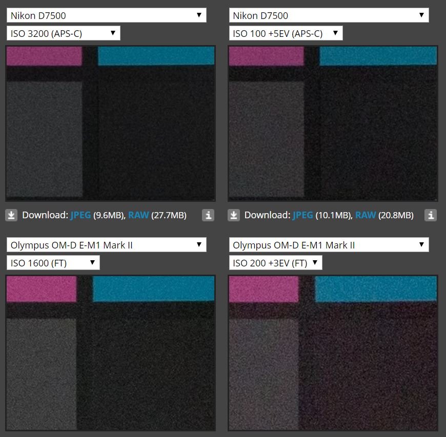

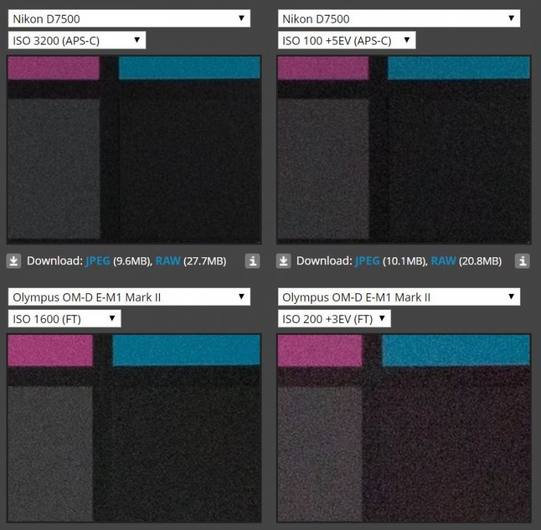

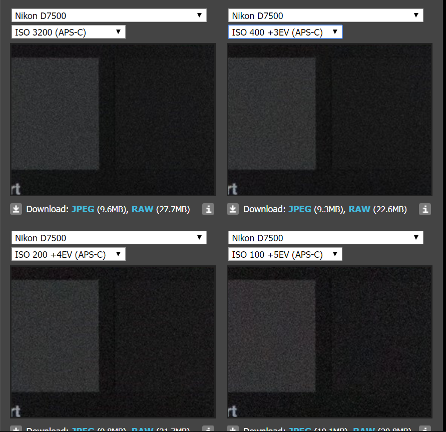

  5. 1 hour ago, Interceptor121 said:
    Where have you got the data from? Best case there is 0.3 Ev benefit between a current 20.7 Megapixel APSC that goes into a Nikon and a 20.3 MP MFT sensor that goes into an Olympus
    If you look at dynamic range, you have at least 2 EV difference, if not 3 EV between a Nikon D7500 and EM1 Mark II.
    This dynamic range is very important for UW shots, as it greatly improves the ability to adjust WB.
    screenshot.thumb.jpg.05160c3bca610f521791638461273ff6.jpgof
    Also important feature of Nikon camera, is "ISO invariance", meaning that you get equivalent results by underexposing image at ISO 100 and then correct exposure in post processing, or by pushing the ISO when you take the shot. This means that when you color correct your picture (and over expose red channel) the result will be less grainy.
    You also have the issue that the EM1 Mark II has a minimum ISO of 200, where the APS-C starts at 100. You'll get a less grainy image to start with.

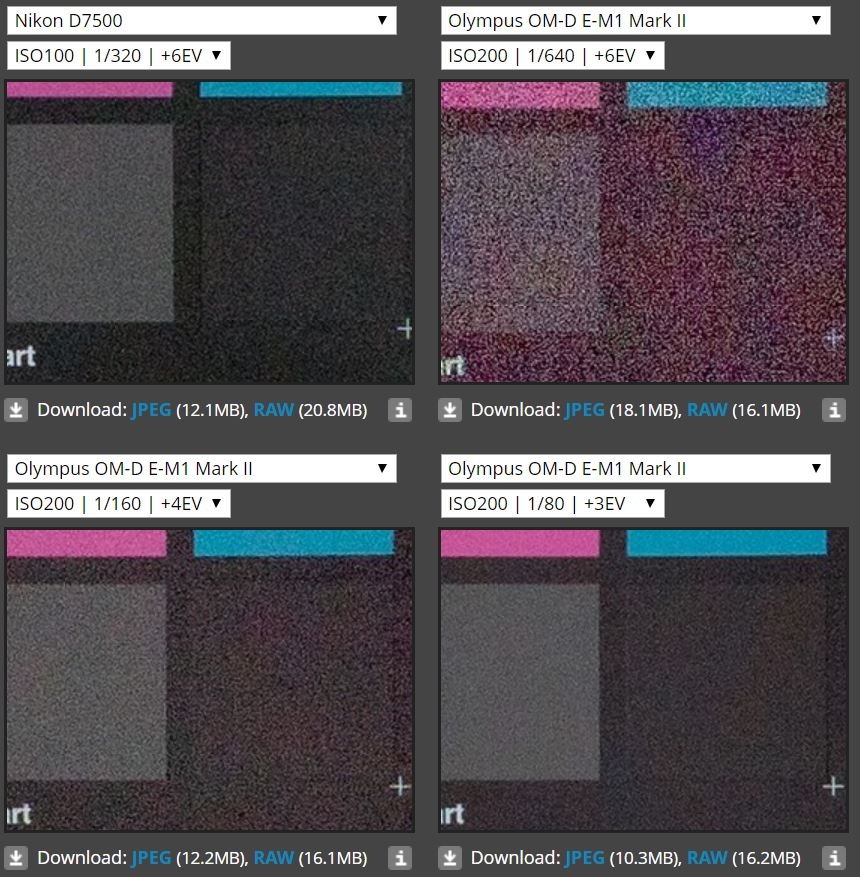

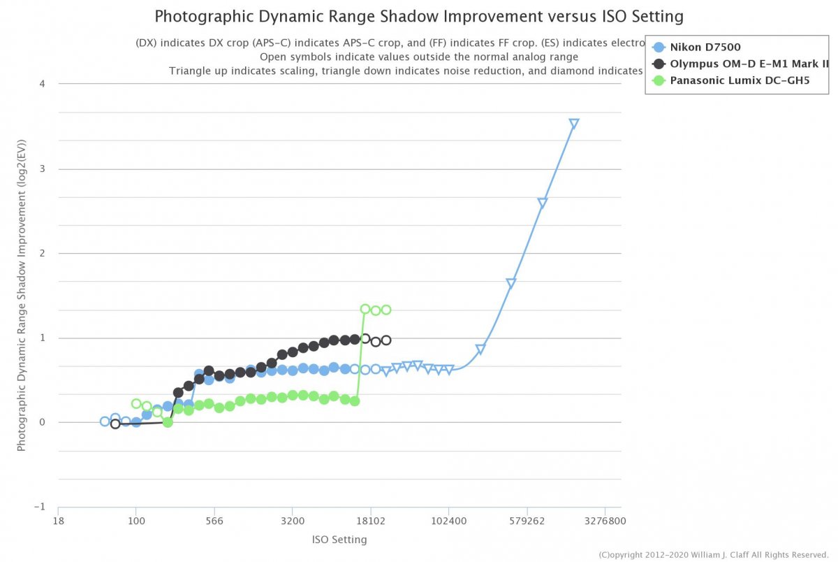

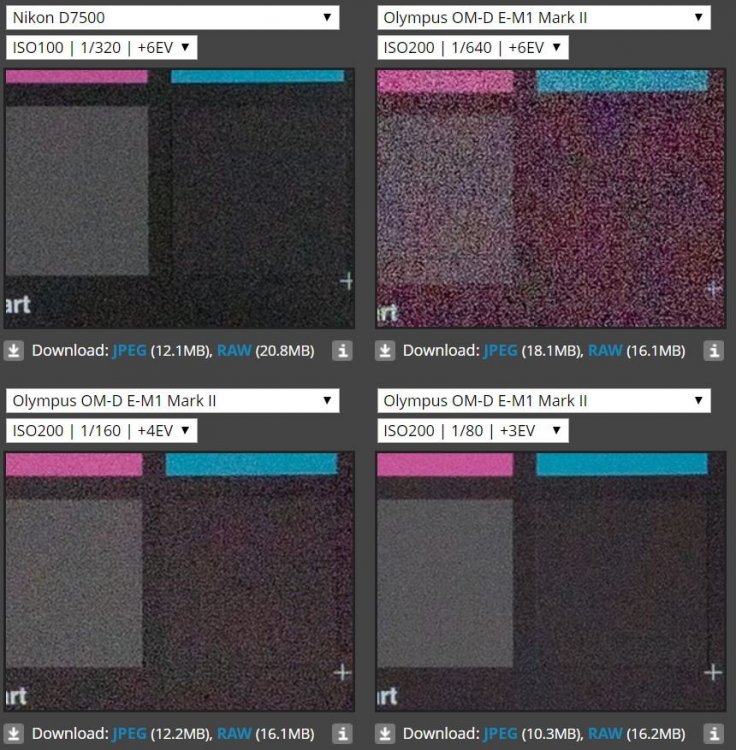

    Those shots do not say anything about dynamic range and are not meant to compare cameras between themselves but just on its own and it shows if for a certain camera it makes sense to raise the ISO or not to recover shadows.

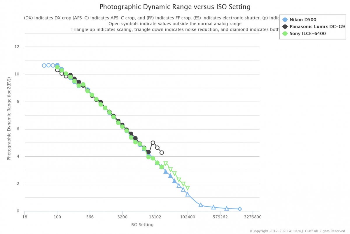

    The graphic below is a measure of dynamic range instead comparing D500 G9 and Sony A6400. The only benefit limited to 0.3 Ev is in the range below ISO 100 however consider that you can actually rarely go there except for macro where DR is not a consideration. I have not included the OMD EM1 MKII as actually that camera is one of a kind and has a higher DR than anything else (though is not ISO invariant like instead Panasonic cameras and new olympus are)DRD500G9A6400.thumb.jpeg.95293ecab58eae37c26ab1ca3986f984.jpeg
  7. Indeed "dynamic range" was an improper term for DPreviews measurements that I quoted, it's "exposure latitude" and "ISO invariance".
    However I find them very relevant for UW photography.
    We often have to correct WB in our photos, to compensate the filtering of colors by water. This means that we have to push selectively the exposure of the Red channel when developing the raw file in post-processing. So what matters is not the classical dynamic range (difference between the lightest and darkest areas of a picture), but by how much we may push exposure.

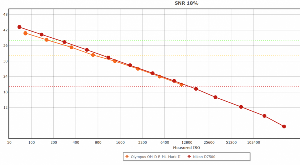

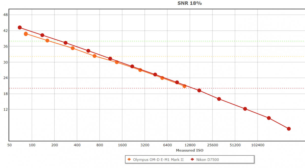

  8. Actually those graphics only tell you how the amplifier of your camera work. If you look closely when you move between 200 and 400 ISO the noise takes a hit at 200 this is because the camera has two gain circuits I have included here the same bit with the D7500 to include ISO 200 you can see that it looks noisy
    In terms of ISO invariance actually some MFT cameras today are better than Nikon or Canon example GH5 here vs OMD EM1 (that is not so invariant) and D7500 that has a bump at 400. I think those charts are only good for marketing purposes and really say nothing useful except make you understand how your camera works in terms of gain and if there is a single or multiple amplifires. Nikon seem to have two as there is a bump in all models pretty much at 400
    One metric that I have found of some use is the DxoMark Sport Value which is the highest ISO you still get SNR of 30 dB 9 Ev of DR and 18 bit color depth. It shows 1482 for the D7500 and 1312 for the OMD EM1 which is 0.177 Ev so nothing really too exciting anyway.
    So when I combine the ISO to get a decent image together with the actual usable dynamic range I get same value on ISO and DR delta of 0.77 Ev take into account that some MFTs like the G9 have a delta of 0.33 Ev on DR due to the area below 100 and in terms of usable ISO get to the same value which is why I started this post in the first place
    In real life I shoot my GH5 at max ISO 800 and when I am on a boat with APSC and FF there is no difference with APSC on actual real life images, if there is it was not because of the camera but the operator
