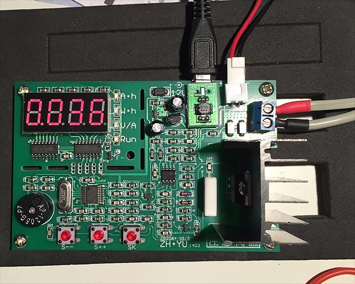

  14. In my hands at least and using this battery tester, eneloops (white or black) after a refresh cycle sometimes show much less than the expected capacity. I have an old set of white (2000 mAh) batteries that when new tested at 1 amp discharge and gave like 1900 mAh results. Over time they drifted down. I refreshed them in a LaCrosse battery charger and after refresh and then fully charging them they were only 1300 mAh. If they do test at full capacity on a 1A discharge they appear to work fine in strobes. I also have been looking at internal resistance and it goes up on older batteries even after discharge
    Bill
