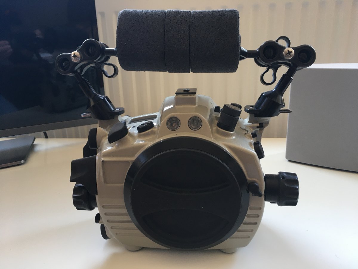

  14. I was going to set up my housing and try and figure it out. Something to do! Will report back
  15. So, here's a ULCS 8" arm loaded with 2.5 pieces of Stix jumbo sized.
    This seems to fit quite nicely and, in addition to providing a nice carrying handle, it would give about an extra 450gms of buoyancy for the cost of a pack of Stix (about €45) plus an extra 8" arm (say, €35) compared to using a float arm.
    But, yes, it does block the focus light attaching point. Darn.
    I think I'm going to try threading my current cord-woven carrying handle through some Stix first. If this proves too awkward, I may well get another 8" arm and, as Barmaglot suggested, a couple of triple clamps.

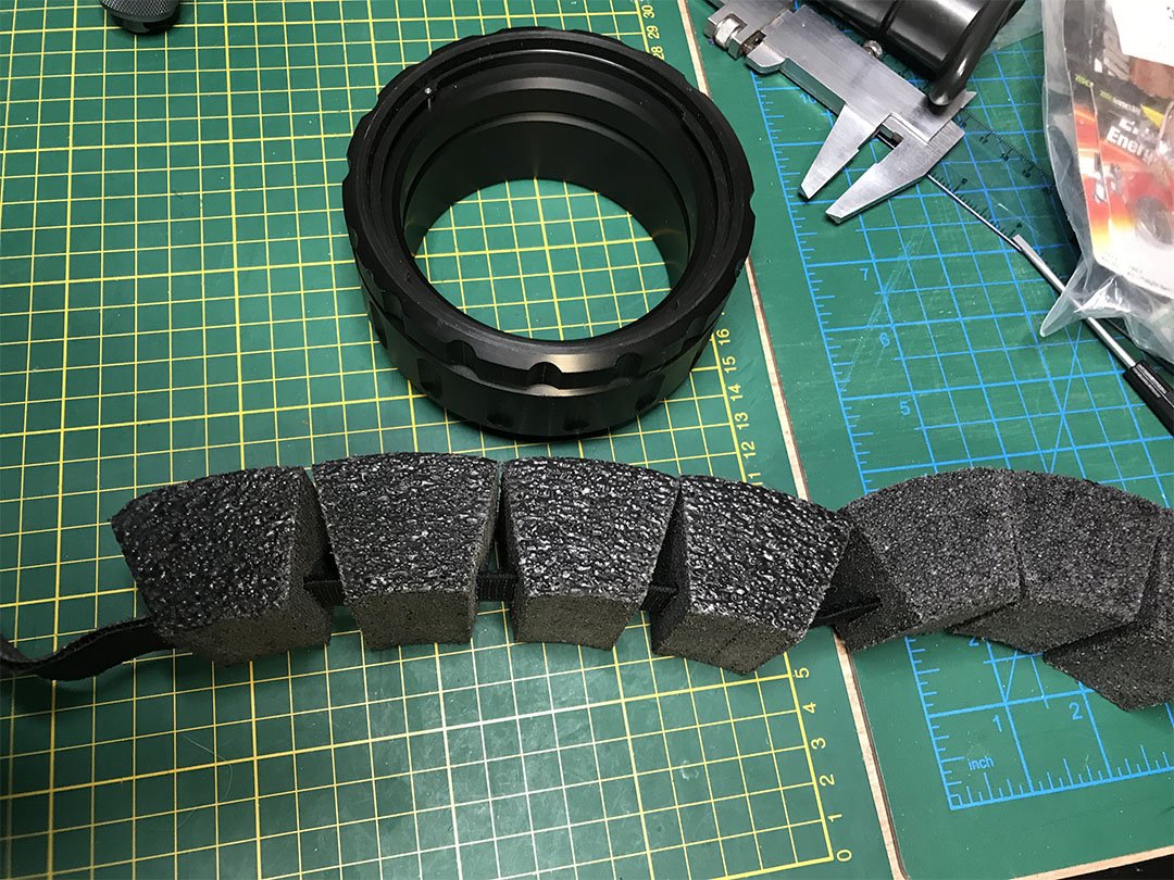

    Can you actually remove floats from the belt?
    Any chance you could take a photo of the area of the belt where there are no floats? This would give me a better idea of whether the Subal focussing knob (its quite big) would fit in the gap with the strap of the belt.
    The belt is  a velcro strap with several segments slid onto it.  You can move the segments around or add/remove them to fine tune buoyancy.  Here's a couple of photos, the first shows the belt on one of my old Subal Type 3 extension rings (approx 115mm in diameter).  You could make the gap larger by removing a segment or two.
Marelux
