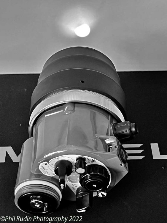

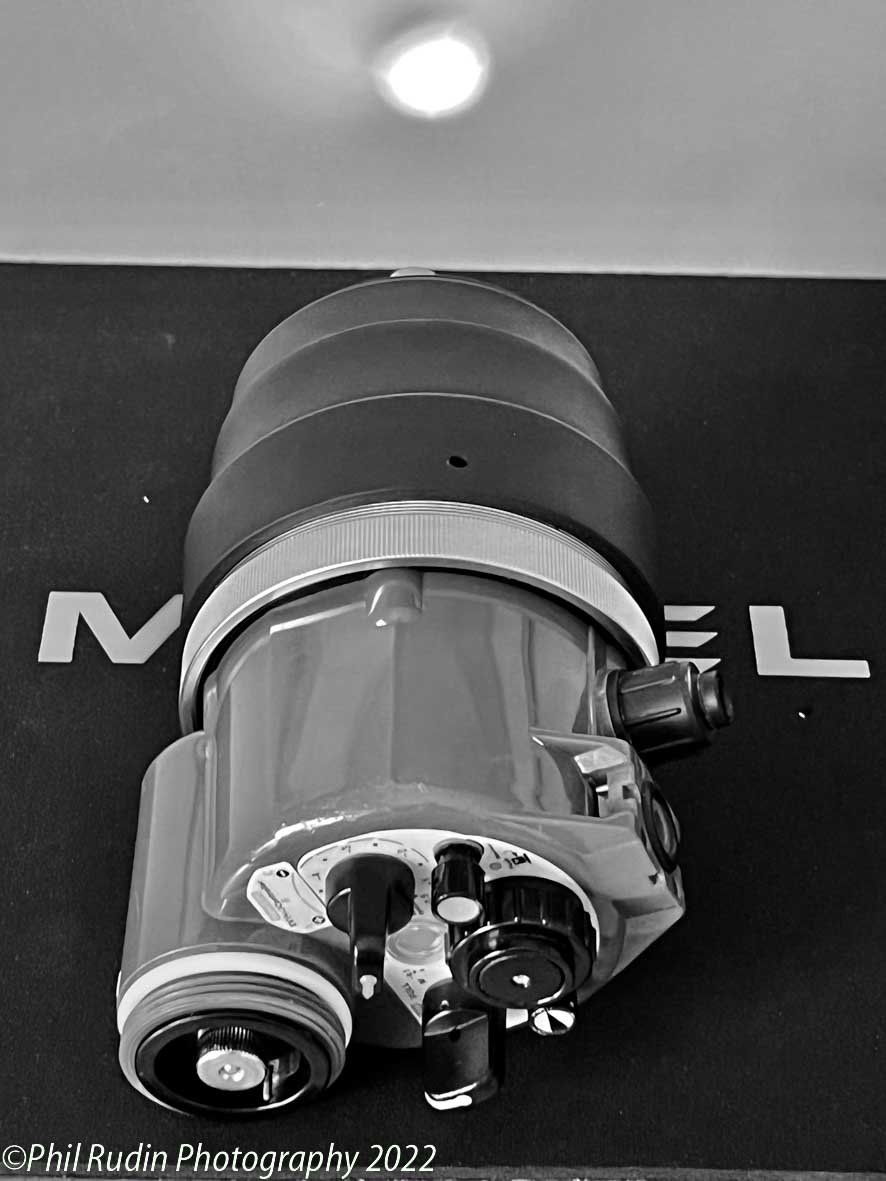

  6. I have attached two photos of the light pattern with the smallest (20 degree, 10mm inside diameter) attachment first at 12cm and the second at 5cm from the flat surface. I have used Inon strobes starting with the Z-220 for decades. They are great products and work well with a verity of snoots. The biggest problem with the Inon snoot is limited ability to change the size of the light beam. As you can see when you move the strobe closer to the flat background the diameter of the light remains about the same and the closer you get the more the light spill's over into areas where you don't want it.
    You can see other examples of the verity of light beams in the Marelux SFOT thread below.
    This is a great entry set for beginning shooter's.
    P.S. I live in S.E. Florida near the Blue Heron Bridge, if you come this way to dive you are welcome to barrow my Inon snoot for a test run. PM if you are interested.
