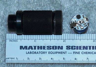

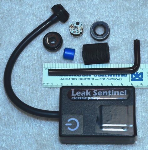

    Here is a photo of the entire assembly, with the vacuum pump at the bottom; the disassembled leak detector is shown above the 6 mm hex wrench. The electronic vacuum detector is the small round disk in the top middle, the blue battery is under it; the Allen hex wrench is used to tighten the mount ring; the electric pump is at the bottom with its screw-on hose on the left.
    The vacuum leak detector unit on the left, with the electronic vacuum detector unit on the right, it is the small white disc.
