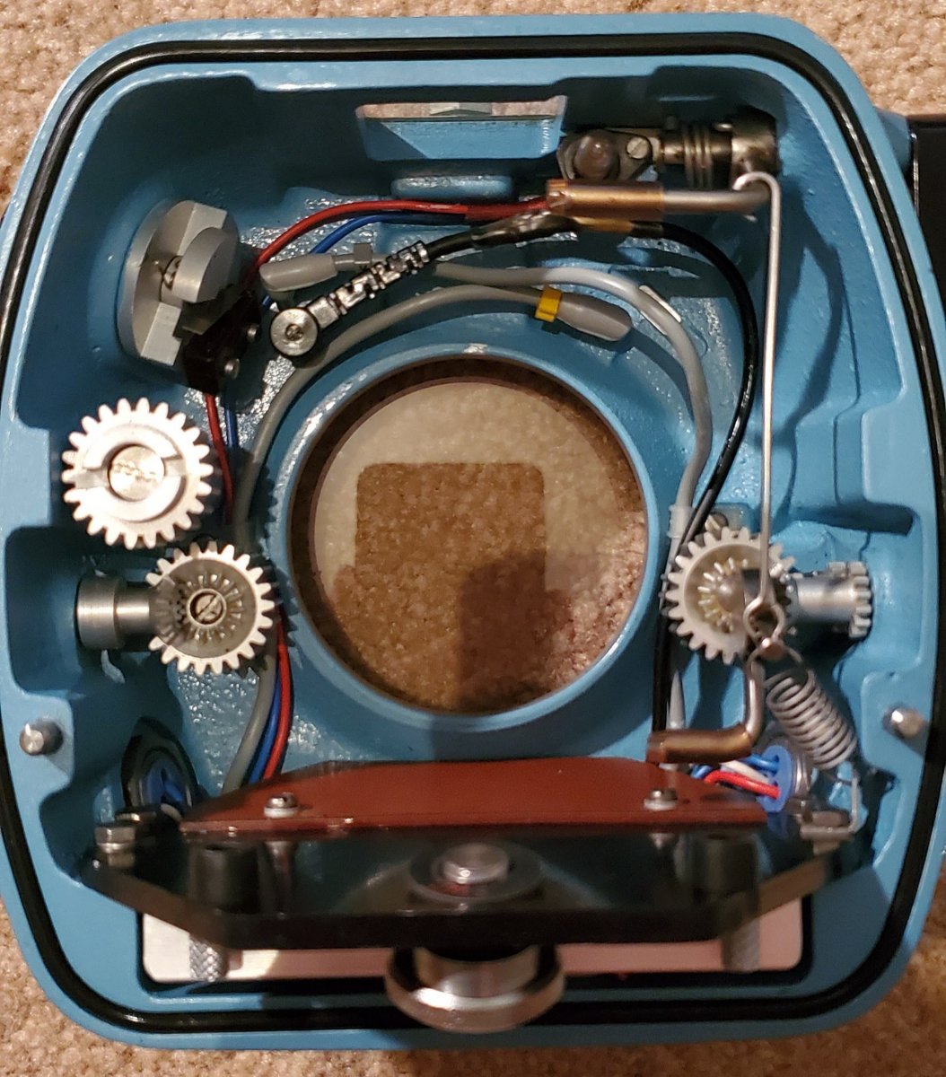

  11. Interesting, there are 3 PC cords! Two gray, one black. 20200831_190211.thumb.jpg.7e3312d92b3ddf26d9c7aa4a66699829.jpg
  12. I guess the black one was added. Do you have a volt-ohm meter aka multimeter? You can use one to test the conductivity between the plugs and bulkheads.
