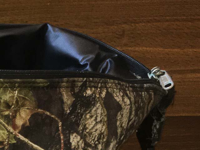

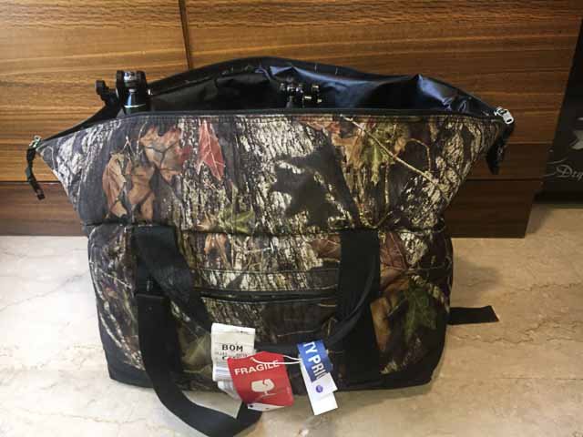

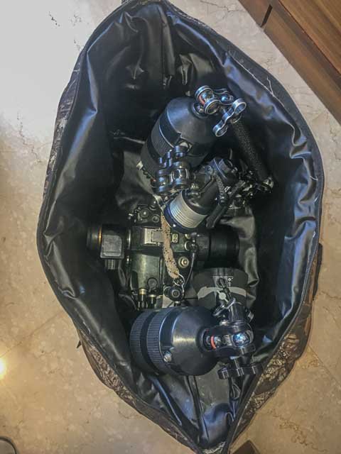

    Hi Tim,
    I have been using this bag :  https://www.polarbearcoolers.com/product/original-48-pack-soft-cooler/
    since 2012. Yes the zippers tend to get verdigris but every time I am back from a trip I just spray some silicone based spray such as
    https://www.amazon.com/3M-Silicone-Lubricant-Net-Fill/dp/B0002BBX4Y/ref=sr_1_1?dchild=1&keywords=Aerol®+Silicone+Lubricant+Spray%2C+(300g%2F513+ml)&qid=1600410007&sr=8-1
    and the bag is still going strong !
    Its very large and takes in a Nauticam Housing for a 7D with arms and strobes all well tucked in. Also works well as a rinse tank and protection for your housing/camera.
    One of the image shows the verdigris on the zipper. But all works well.
    Diggy
