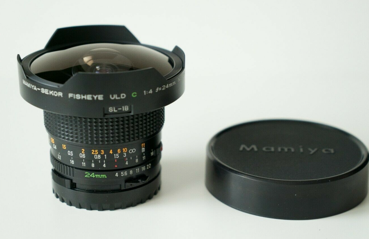

    Edi: There is a 24mm fisheye in the Mamiya 64 lens range - 15mm in 35mm equiv

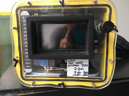

  14. After many months of messing about, I've finally managed to stuff my BM 12k into an existing housing I have that was built for a Red Epic. Shot this footage at 75 fps in 12k and then 'expanded it' to fit 16x9.
    Lens is fixed at 8mm, f 11, focus at 22", ISO 1000.  Looks pretty good on my 8k TV.

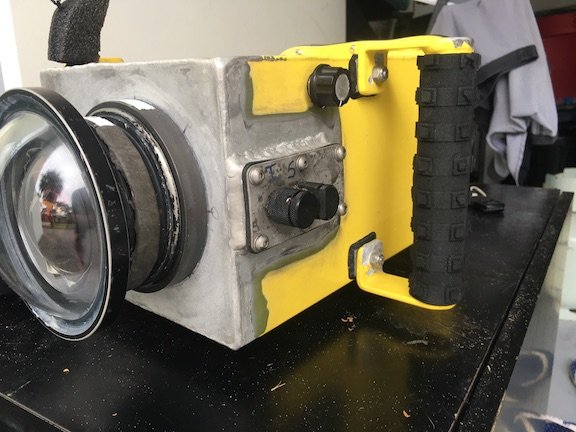

  19. My housing is a shallow water aluminium one custom built by SPL in the USA about 10 years ago.
    It was originally for a Red Epic but I altered it to barely fit my BM 12k and it took many trips to the machine shop.
    I can change the ISO and shutter speed but leave the aperture fixed at f11 for the DOF.
    I have a Shraeger (bicycle) valve installed in the top of the housing and I slightly pressurise it with a bicycle pump to make sure it is sealed before jumping in the water.
    I can turn on/off the BM screen as well but find that the screen overlay info partly obscures the ISO info which sucks.
    If I shoot long takes (like 60 seconds following turtles)  I find that the housing overpressures a bit from hot air.
    I was using a WD black p50 SSD but it got really hot so I changed to a Sandisk Extreme pro which is smaller and does not seem to get as hot.
    Since I use it in the surf, It's not a problem to release air through the valve.
    It's a bit funky looking and was certainly a hassle to adapt the housing from one camera to another, but the results are pretty impressive on my 8k TV which I use as a monitor.
