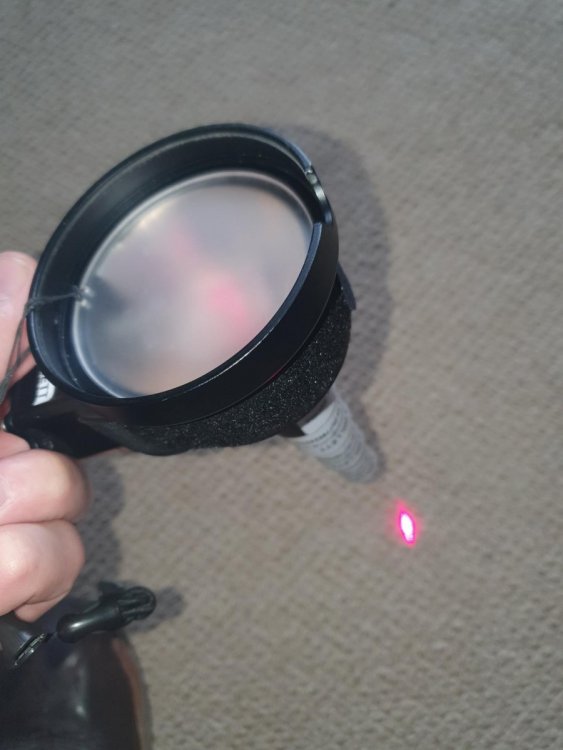

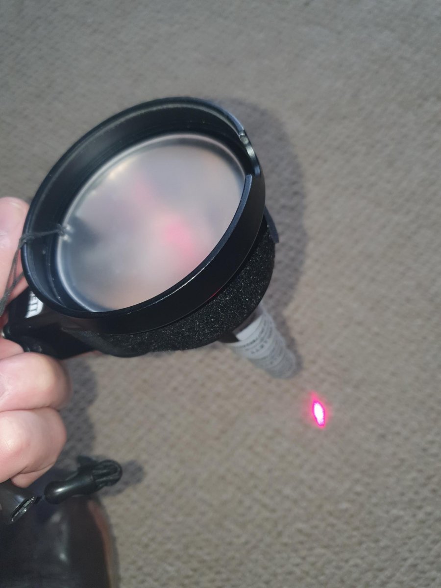

    hi Joanna,  use a 10 bar laser snoot, the one I have is the better version with a Internal laser that emits a  straight out of the snoot port. This is the one you want, not the external laser version. I have another snoot without laser and I find there is no alignment issue with the focus light, under standing the snoot is close to the macro subject anyway.
