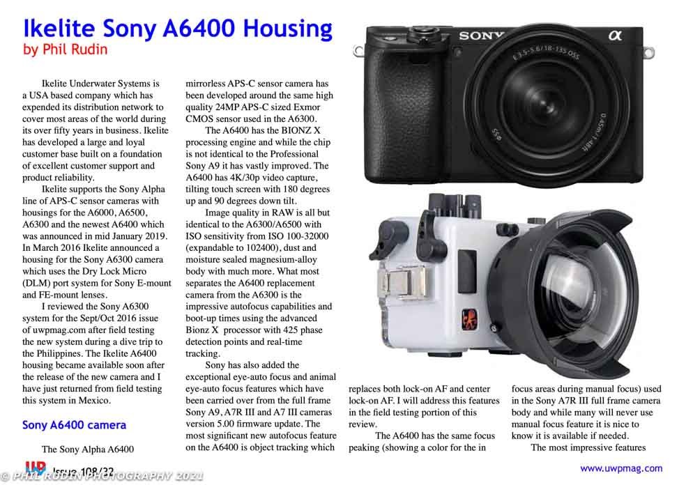

  13. Imacro you may be interested in reading my review for the Sony A6400 and Ikelite housing. Back issue #108 at UWPMAG.com This is a free PDF download.
    Regarding the Ikelite macro port system Ikelite offers two macro ports with the 67mm thread for closeup lenses. This is not a stand along port as it appears  Chris Ross post is inticating if I am understanding correctly. It is a modular system where you can add port extensions to the main macro port for different macro lenses. Some of these extensions also work with different wide lenses behind a dome port.
    Sony and Zeiss 50mm macros both work with macro port 5516.45 and 5516.55 extension.
    Sony 90mm macro, Canon 60mm F/2.8 macro with metabones adapter and Canon 100mm macro with Metabones all work with macro port 5516.50, the longer 90 and 100mm lenses use extension 5516.70 while the 60mm uses extension 5516.55 same as the 50's.
    Fantsea housings also supports the A6400 and both Sony and Canon macros with lens adapter.
    Meikon, AKA Seafrog supports the A6400 in the salt line but macro lens support with proper length ports is limited.
