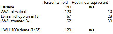

  9. As to what to do if you are doing the macro and wide angle separate , the macro is easy, you probably just need a macro lens and matching port.  Getting to 1:1 is a great starting point but ask your self is you think you'd like to go further in which case you want to buy a lens/port which works well with a closeup lens.  Conversely if you dive in temperate water having a shorter focal length macro is good if you also have larger subjects in the3-8"size range maybe.
    Wide angle with WWL is one option giving 130° diagonal field with the right base lens.  Taking that off UW is a bit of a big deal as it is large and heavy - too big to park on a strobe arm so you typically would have a 10-30mm equivalent zoom lens with some barrel distortion for the whole dive.  Nice for larger animals and can do CFWA on reefs.  However the king for that is still a full frame fisheye.  Here's a chart to allow you to compare field of view - I based it on the horizontal field to make comparison easier as fisheye, rectilinear and wet lenses are not directly comparable  if you use the diagonal field of view, the field of view is stretched most in the corners of a full frame fisheye.
    You can see that WWL gives a similar field to your UWLH100 plus dome.  The second column lists the equivalent focal length for a rectilinear lens.  One option that some people have been using is an adapted 8-15mm fisheye on m43.  That goes from fisheye through to roughly 28mm equivalent which is slightly zoomed in on your current camera without wet lenses.  It is a relatively expensive option and needs a housing that will accommodate the adapted fisheye.  You can do this on Nauticam using special adapter along with the Canon zoom gear.  The bonus is the dome is small and lighter and you are having to deal with a detachable lens that needs burping on every dive.  You can't do this with larger sensors, though the tokina 10-17 goes close on an APS-C sensor camera.
    you choices will depend a bit on what type of wide angle you do - reefscapes and CFWA in clean tropical water, large animals, shipwrecks all have slightly different needs.
