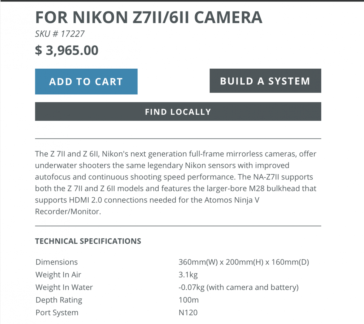

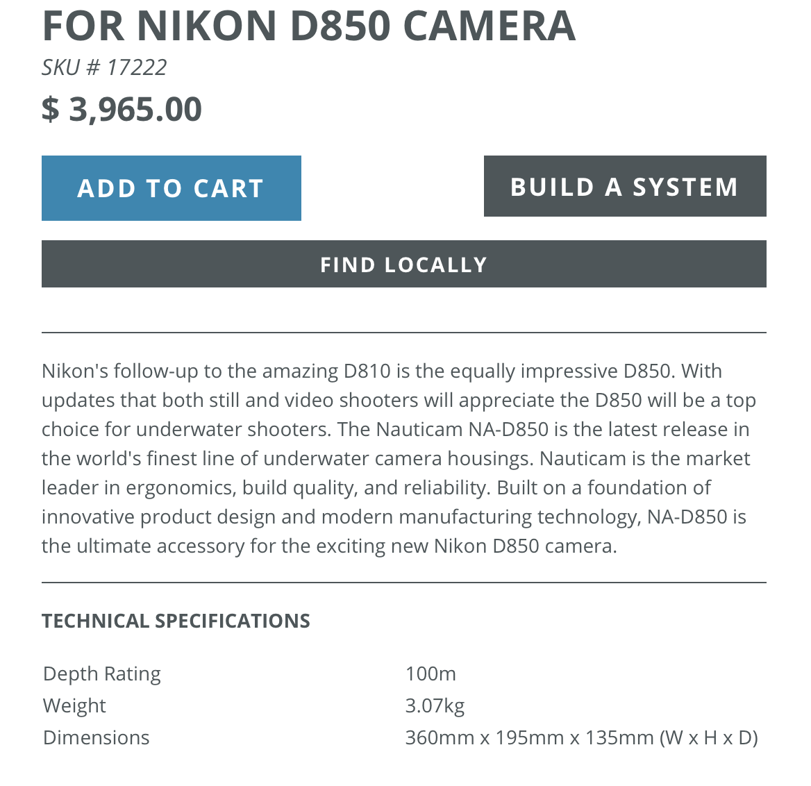

  1. I am a Nikon shooter. I Have the Nikon D850 and the Nikon Z72.
    I am now at the final stage of my research before buying my first UW housing and equipment .
    For land photography (wildlife)  I prefer the D850 over the Z72. I was sure that the housing for the Z7 will be smaller and lighter than the housing for the D850.
    Surpassingly I discovered it is the opposite.. Strange...
    Edited by ido

    This had me puzzled too. The isotta housing for the z7ii is much smaller compared to the Nauticam regardless needing an extension ring for the ftz . What i dont understand is, most of the sony FF housing, i.e A7s iii (being just a fraction smaller than nikon), their nauticam housing is much smaller vs nikon. The sony a7siii housings are sized similarly between Isotta and Nauticam.
