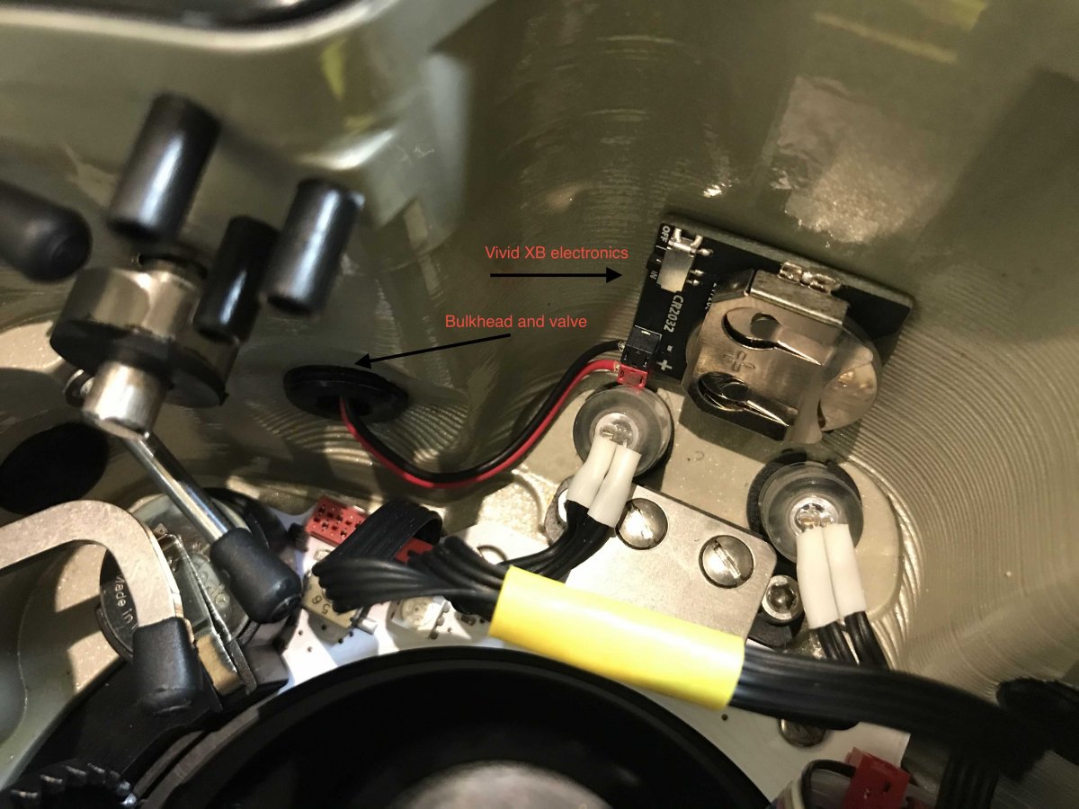

    As Chris says, I use the Vivid V5 XB on a Subal ND500 - I had it on the ND800 too - and am big fan. I started with, I think, the V2 and Vivid are now up to the V5.
    The V5 XB separates out the battery and electronics from the actual valve. This results in a neater, shorter valve which leads through the bulkhead to a cable and then the PCB with the electronics and battery. On my system the PCB is installed above the hot shoe - stuck (gently) to the housing roof with double-sided tape.
    The latest version of the V5 XB is now much neater than the pic Chris attached. Wires are shorter, easier to fit in the housing and just a much more polished product. Vivid have updated the the Sentinel continuously over the last few years and each iteration has brought significant improvements.  As you have experienced, support from Vivid is excellent.
    I've no experience of the AirLock but have no hesitation in recommending the Vivid.
    I'd attach a photo showing the latest V5 XB in my system but, errrr, its vacuumed up and sitting waiting to go diving tomorrow morning! I'll try and post a pic tomorrow night.

  5. 2 dives later.....
    Here's view inside the housing with the latest version of the V5 XB electronics
