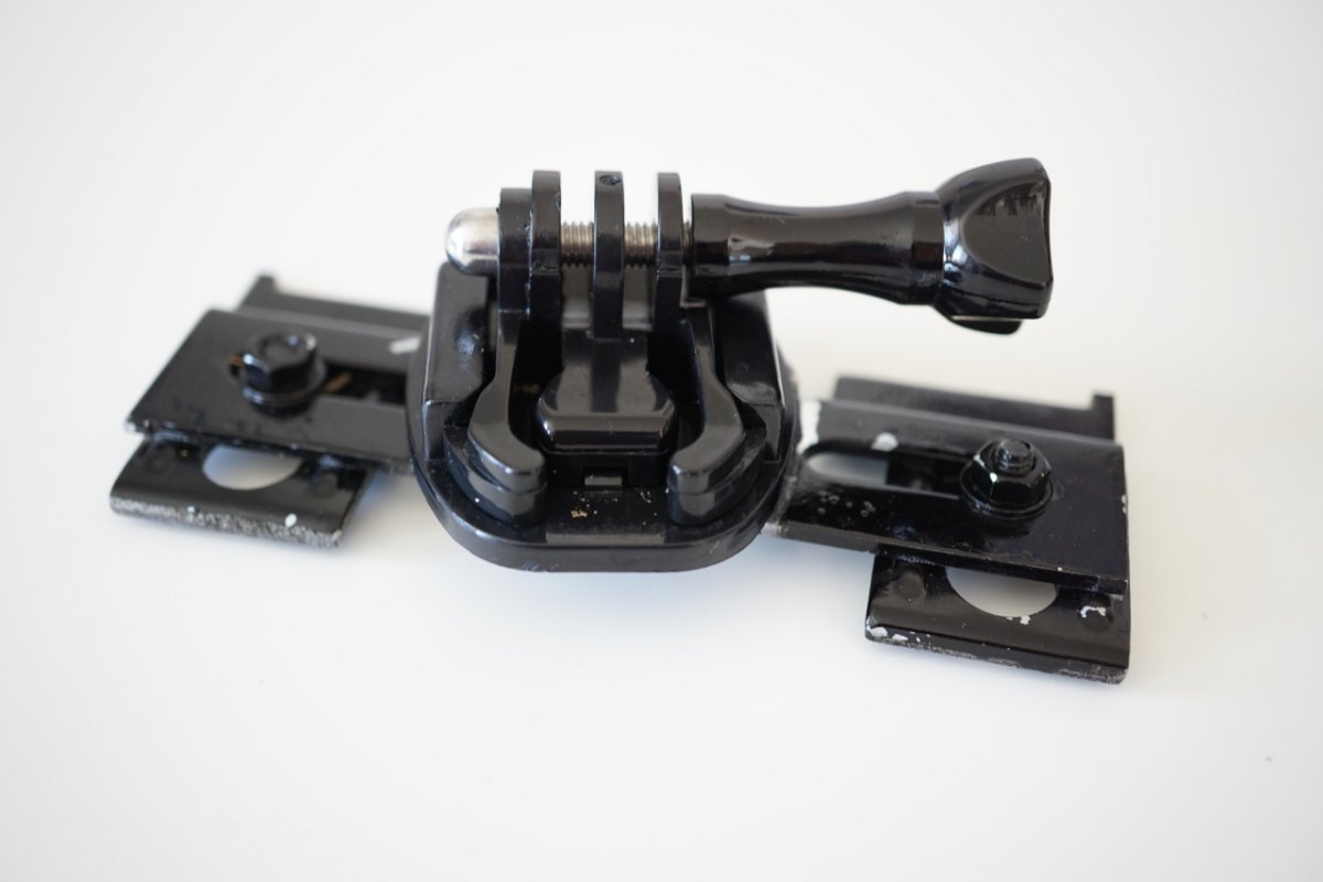

    You can be very creative regarding how to stabilize your camera; it shouldn’t be necessarily a real tripod. Actually tripod is not the best choice, since they’re not that stable underwater and you may have to add additional weight to it. It might be easier to stick your action camera to a lead block. If you want to be fancy you can even combine it with a flexible loc-line arm.
    A very effective stabilisation I’ve just tinkered from scrap metals (aluminium) I found in my DIY stuffs.
    You can see two examples for such DIY stabilisation “tray”. They should be heavy enough but still light to transport them easily.

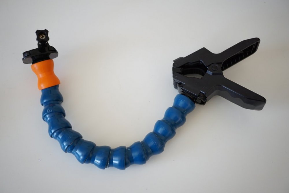

    You can also by some flexible arms with clamps. It can be very useful (you can put a lead block into the clamp)
    Very important is to respect the surrounding and place your camera on the sand or rocks not covered by life.
