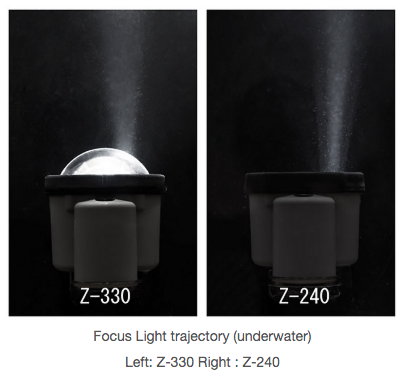

  16. I'm not sure where the LSD/Z330 misaligned pilot light idea has come from?
    I've used this combination a lot and have no issue with it. In very shallow and bright conditions, it can be hard to see, but this is not an issue with accuracy!

    I think it's leftover from the Z-240 days where the pilot light was a true eccentric pilot light that was not ideal for snooting. With the Z-330 they have tilted the pilot light inward which now lights up in the center of the LSD optical tube.
    Attached is an image from Inon's website explaining the improvement.
