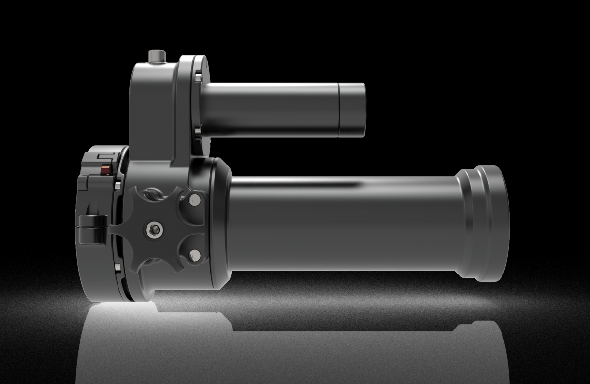

    The website doesn't have any details, but looking at this:
    Dollars to donuts, the coaxial tube is a battery housing, with a screw-on cap on the end to access the battery compartment. Probably an 18650 or a 21700 cell in there.

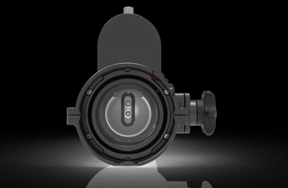

    Looking in the back:
    There's obviously a mirror in the top part, redirecting the aiming light beam 90 degrees. The protrusion at the very top is most likely the on/off/white/red button. One of the circles in the middle is probably the light sensor that does the shut-off, the other is probably the aperture.

    Is that this one?
    https://www.marelux.co/products/smart-optial-flash-tube
    It comes to $550 with the dock and I can't find any reviews on it to confirm how it works and whether or not suited to Z330.
    Found the below info:
    marelux Smart-OFT ,  latested testing data ,
    1. one 18650 battery can support aiming light working continously for 12 hours,
    2. best shooting distance 17 to  20cm from object,
    3. aiming light spot and strobe light spot same size,
    4. at 20cm distance , biggest light spot diameter 65mm, smallest 5mm.
    5.red aiming light only 0.5w, will not disturb or hurt small marine creatures.
    Edited by newdiver
  18. 2 minutes ago, newdiver said:
    Is that this one?
    Yes, that's the one. Backscatter MF-1 + snoot package is also $550 (although right now it's on sale for $500), but don't forget that you will also need mounting hardware and another fiber optic cable to trigger it. I'm really not a fan of the idea of putting it on a triple clamp with a regular strobe; aiming that is going to be a nightmare, and a loc-line arm with cold shoe adapter and clamp is going to be another ~$100.
    Z-240/Z-330 issues with snoots relate to their off-center aiming light, which, at least with some snoot designs, offsets the aiming spot from where the strobe light will hit. Marelux SOFT has its own aiming light, so you don't need to use the strobe's modeling light with it.
    One thing I cannot tell from the photos though, is how easy or difficult it is to attach/detach the snoot to/from the strobe. I use Retra Pro + Retra LSD, and I usually carry the LSD clipped to a D-ring, attaching it to my left strobe when the situation calls for it, and detaching it afterwards. No idea how feasible this would be with the Marelux snoot.
