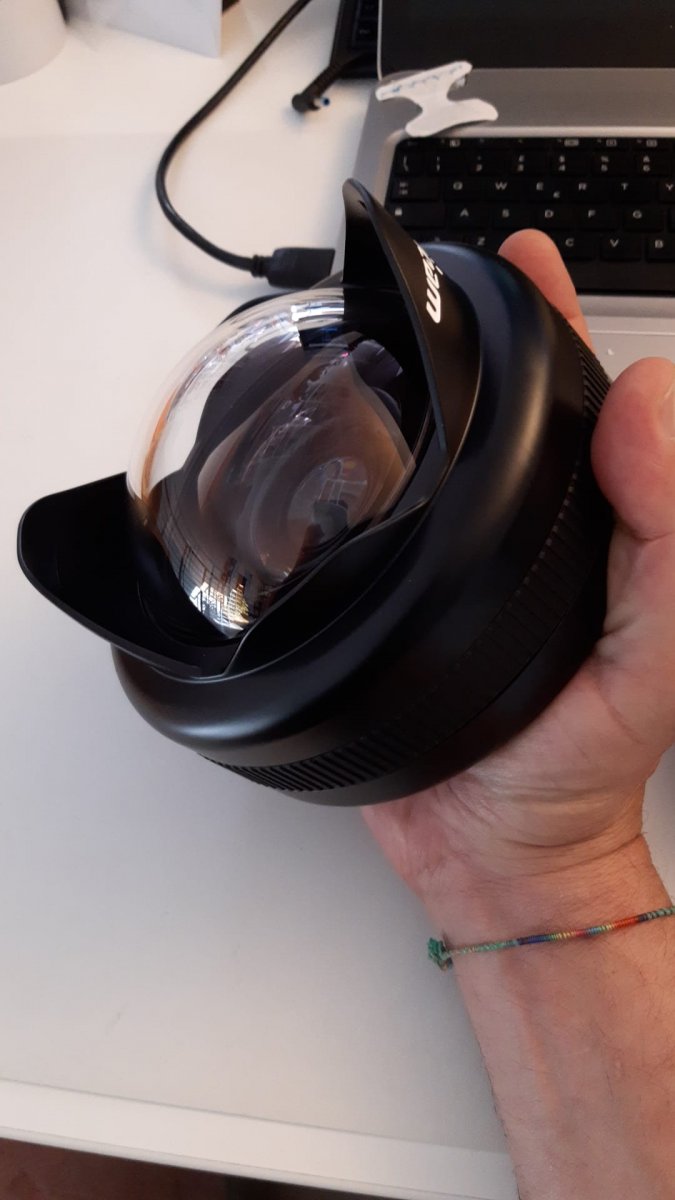

  10. I would not swap it neither on a 20m sandy bottom. The rear lens is very delicate...
    I am a hooligan with my equipment but there is a limit to everything :rolleyes:

  11. On 5/25/2021 at 1:12 PM, Davide DB said:
    But then? I put it in my pocket?
    I think you could put a bridge between the tray handles, over the housing, something like this, mount a lens dock in the middle and park the WWL-1 there when it's not in use.
    I have that bridge. I used it on my old GH3 housing. Now I have the external monitor hence no way to use it. Regardless of the solution, IMHO it's too risky. One thing is to stove a lens like CMC-1 on the arm (or in a drysuit pocket) but WWL1 is too bulky.
