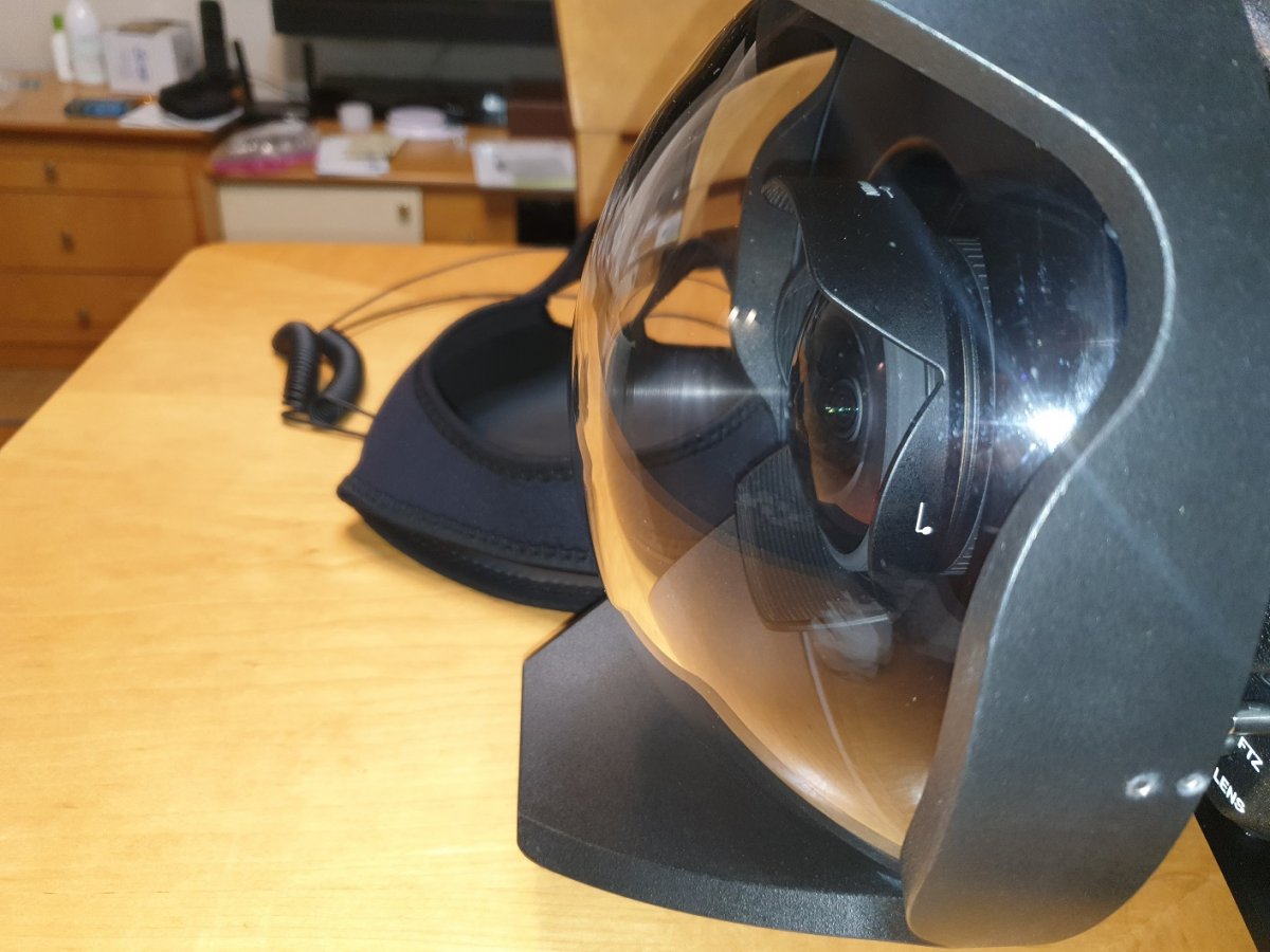

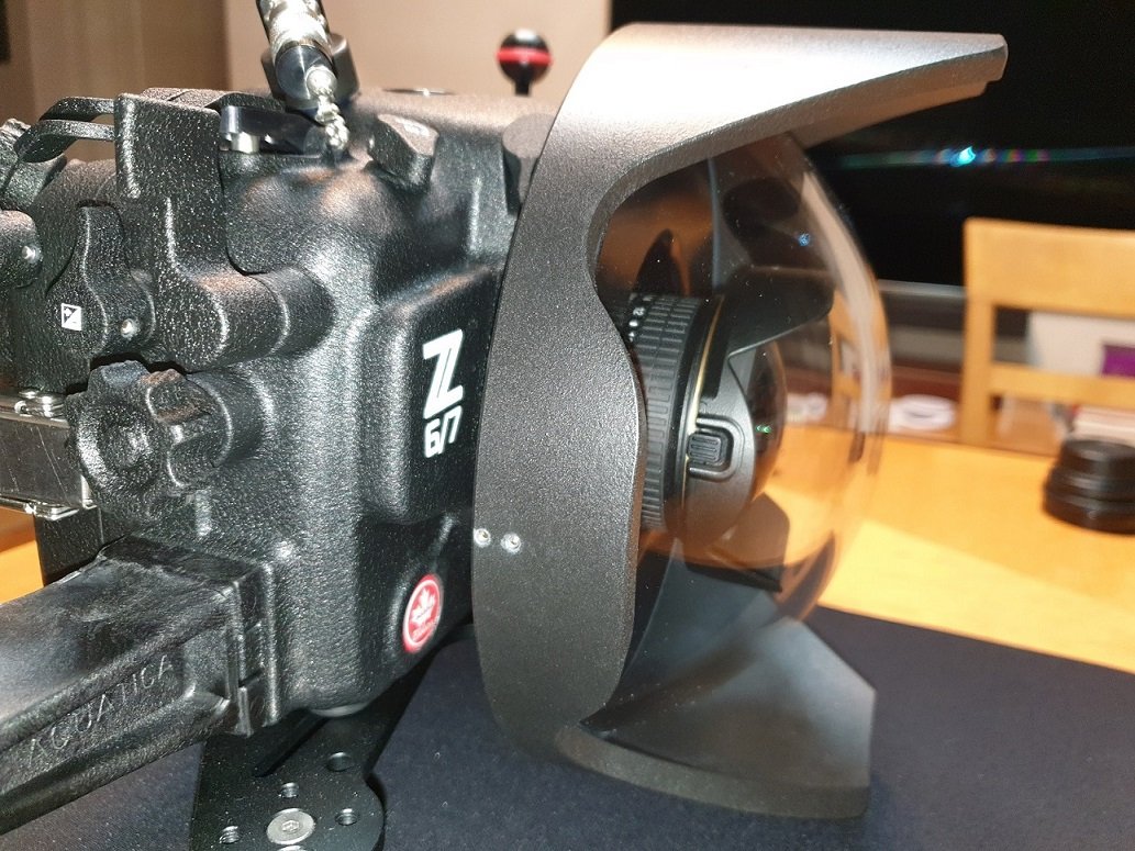

  1. hello all..
    i was buy aquatica housing 3 month ago..
    my system is nikon z6 ftz 8-15mm fisheye lens.. and 8 inch dome port
    when using nikon 8-15, the aquatica lens port chart does not need extension port...
    but i think too closer dome to lens....
    i haven't used it in water yet
    Need extension port??

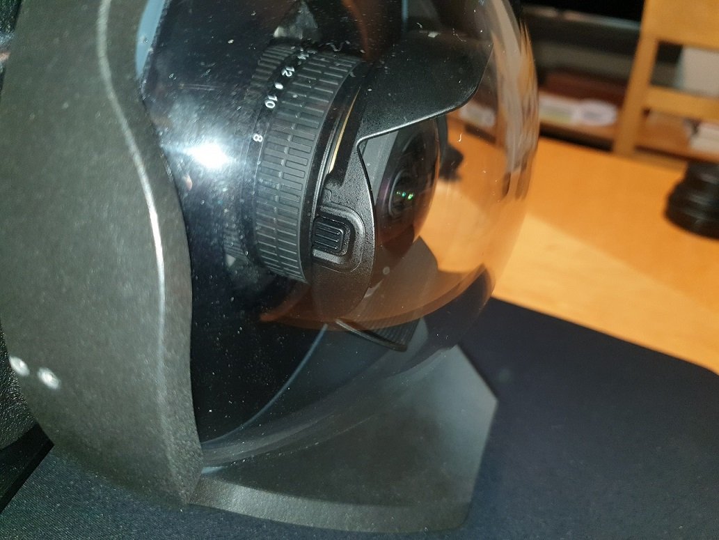

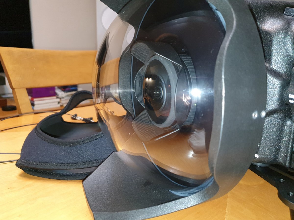

  2. You are correct, the port chart says you do not need an extension with the 8"dome.  I expect it will work, fine however I would check if the dome shade causes vignetting at the 8mm circular fisheye end of the zoom range, normally the dome shade needs to be removed.  I also believe the lens hood on the lens needs to be removed if shooting at 8mm.  Here is a review article on the lens:  https://wetpixel.com/articles/review-nikon-8-15-mm-f-3.5-4.5-fisheye-lens/P1
  3. Yeah, if you want to shoot the Nikkor 8-15mm at the 8mm end, you ned to remove the lens hood - otherwise it vignettes the circular 8mm image.
    Likewise, as Chris explains, you may well have the same problem with the petals on the dome.

  6. I would suggest trying it as is - you can take an image and check for vignetting at 15mm on land and decide if you want to remove the dome hood or not,  On your first dive, take some shots you can use to evaluate it with detail to the corners - even if it is just sand.  If you are happy with the shots - leave it as is.  Normally the manufacturers do a decent job of placing the lens correctly - they have setups to allow them to test the amount of extension needed.
    Before worrying too much about your corner quality take some shots on land to compare and be sure you stop down enough, at least f8 - possibly a little more maybe f11-13?  Try a few different apertures to see what you find acceptable.

  8. Based on the images above, you definitely need an extension ring.
    The lens's nodal point needs to sit in line with the dome port's back panel. The issue is not vignetting (although it may do this too) but it will be optically poor if it is incorrectly positioned.
    I would consult with you Aquatica dealer to see what they recommend.

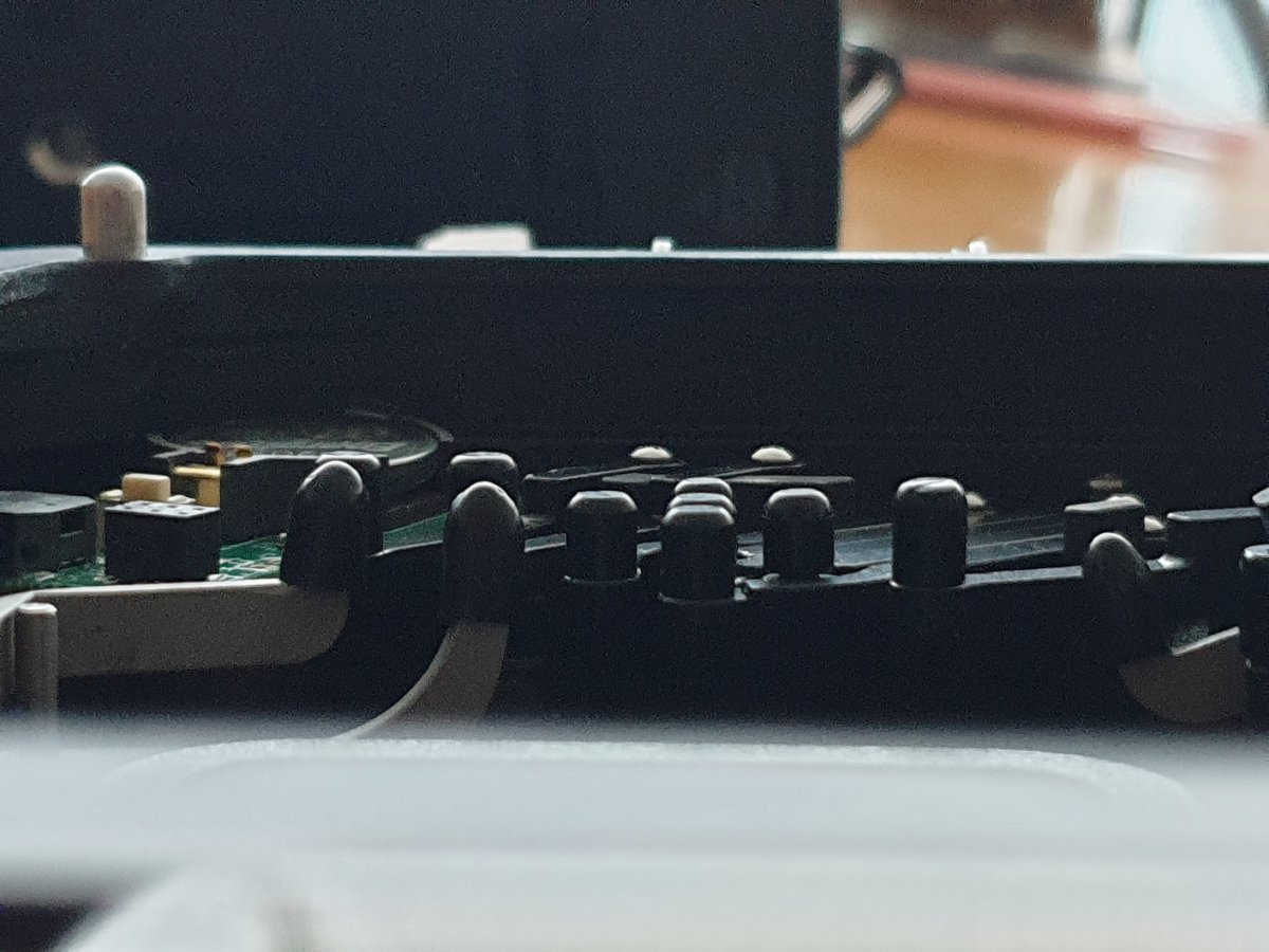

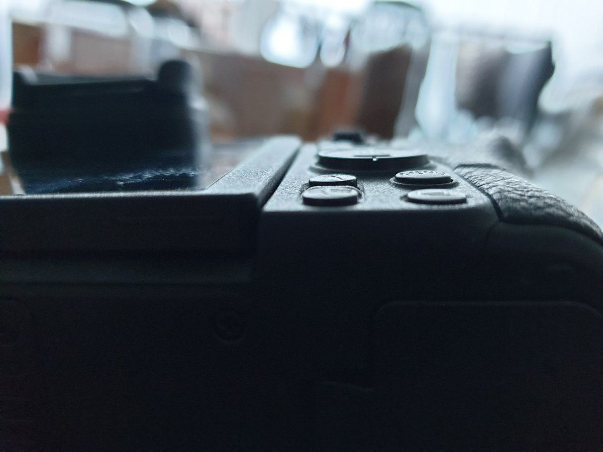

  15. It's a little different from the extension ring, but I think I found the cause of the button failure myself.
    The ok button, down button and right button, which are not working as shown in the picture, are slightly higher on the camera body, and the rear connections of the housing are made lower to suit the camera height.
    With the camera mounted on the housing, pull the lower part of the camera a little bit with force to operate the aperture wheel normally.
    And if you infer that the upward button always works, it seems that the bottom of the camera body goes deeper into the housing than the designed one.
    Maybe it's a camera alignment problem. I think the lower part of the camera body goes in a bit more than the angle designed in the aquatica housing.
    However, when I close the back plate of the housing, the camera is pushed back, so I couldn't check if the button was working properly.
    I'm going to deliver this to Aquatica.

  17. Hi Edy,
    I think that it is probably not a good idea to compare either extensions or other lenses. Although you can draw some general characteristics, the position of cameras within housings varies which affects the required extensions. Similarly, different lenses haver different nodal points, which pretty which means that each type (brand/focal length etc.) of lens has fairly unique characteristics.
    So Seacam's extensions will not be the same as Aquatica's and what is needed for a Canon 8-15mm will likely not be the same as that needed for the Nikon 8-15mm!
    From a purely theoretical standpoint,  the issue here is not vignetting. Any lens will benefit from a dome port curve that is as gradual as possible. The more curved the virtual image presented to the sensor, the greater the corner distortion. While a fisheye lens "hides" this better than a rectilinear lens, it is still there. By pulling the lens back away from the dome, will allow it to use the full curve of the dome.
    I use a 20mm extension with the 8-15mm and my D850 in a Seacam housing and (typically) a 7" port. I find it provides acceptable (to my mind) corners down to about f/8 or so. I can use the same port to about 12mm before it vignettes, and if I remove the dome shade, can use it all the way to 8mm. I should stress that these findings may not work with your housing/port...
    Adam

  19. Edy, When you say that the 21.5m extension does not cause vignetting that is because you are only using it at 15mm (which is apparent from the lens and dome hood in the photos). Even without the lens hood on, I am pretty sure you would have vignetting with the 21.5mm extension as you move to shorter focal lengths.
    As for the correct dome placement, it would be great to see some comparison shots with the different extensions since, like you, many others probably also shoot this lens at 15mm exclusively.
    If I take a picture at 8mm with the extension ring I'm currently using, there will be no vignetting if I remove the lens hood and dome hood.
    Nikon 8-15 lenses vary in circular size depending on focal distance. I didn't see the vignetting in either focus.
