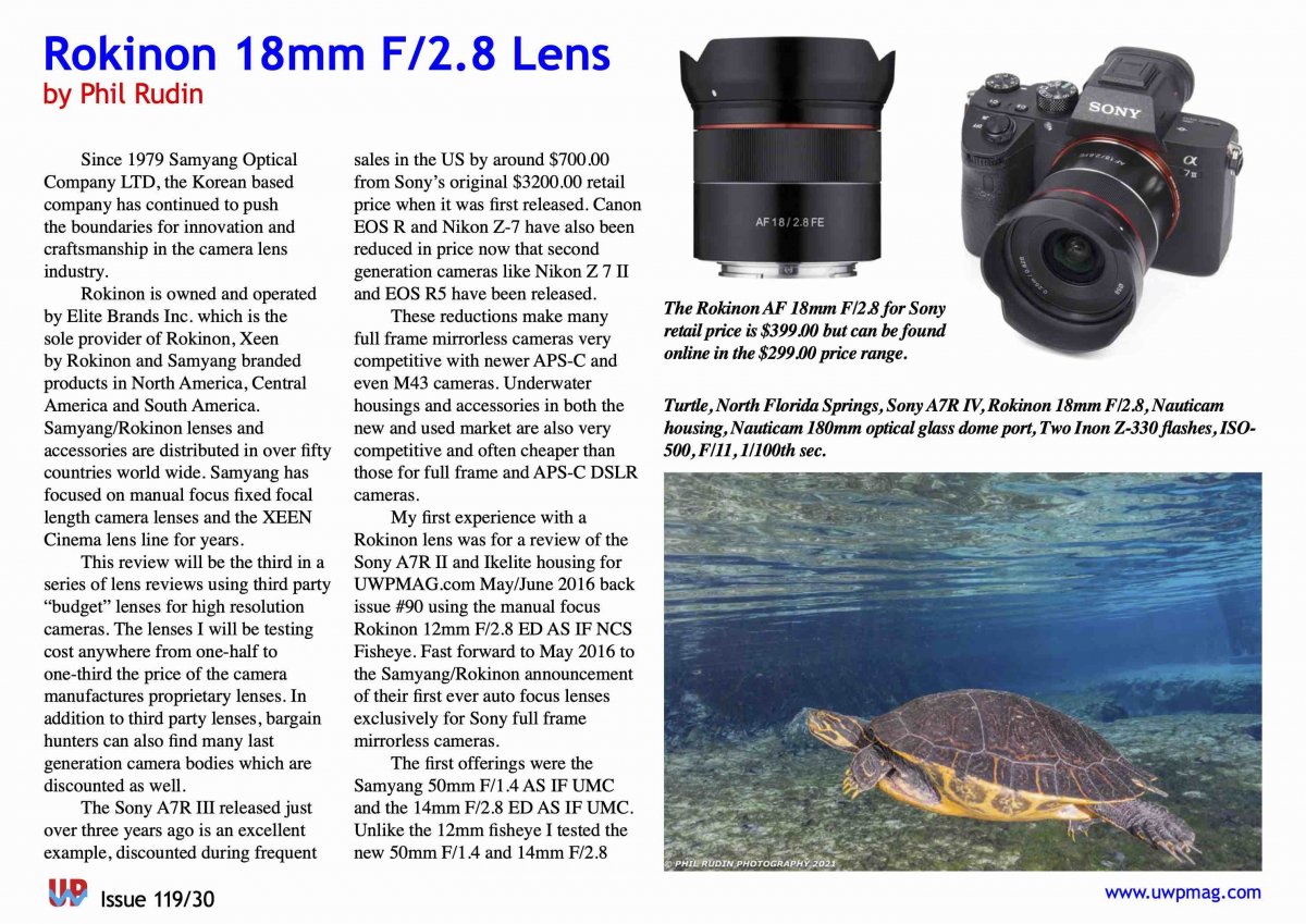

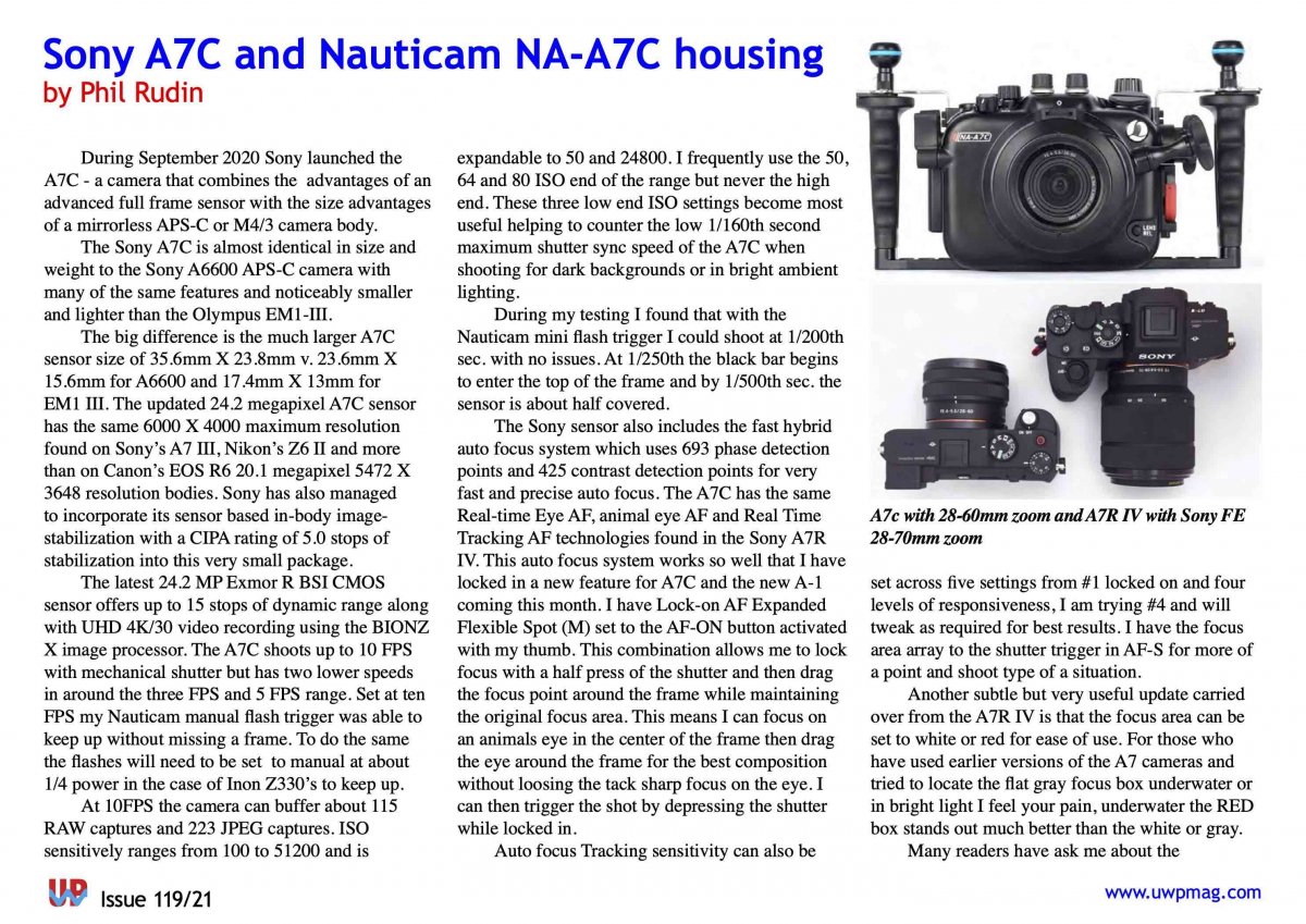

  3. These are two reviews you may want to start with. The full reviews are in the back issue section at uwpmag.com top of the home page. All are free PDF downloads.
    Thanks for this, Phil. I'm aware that Rokinon brought out the AF versions of some of their wide-angles and they are reasonably priced too. I wonder how easy it would be to use the 28mm FE with the fish-eye adapter instead. The 28-60 is a neat and inexpensive lens. It only opens up to f/4 but this isn't an issue with good low-light performance and the fact I wouldn't open up this much anyway. It's a shame it's not a 24-70 though! Anyway, I'll grab that PDF.
    By the way, my interest in the A7C has been roused by the fact that Ikelite are currently testing their prototype housing for the A7C. The Nauticam version is WAY outside my budget but nice to see housing manufacturers are taking the A7C seriously. I love it as a stills camera for land-based stuff. It's a really underrated camera.
