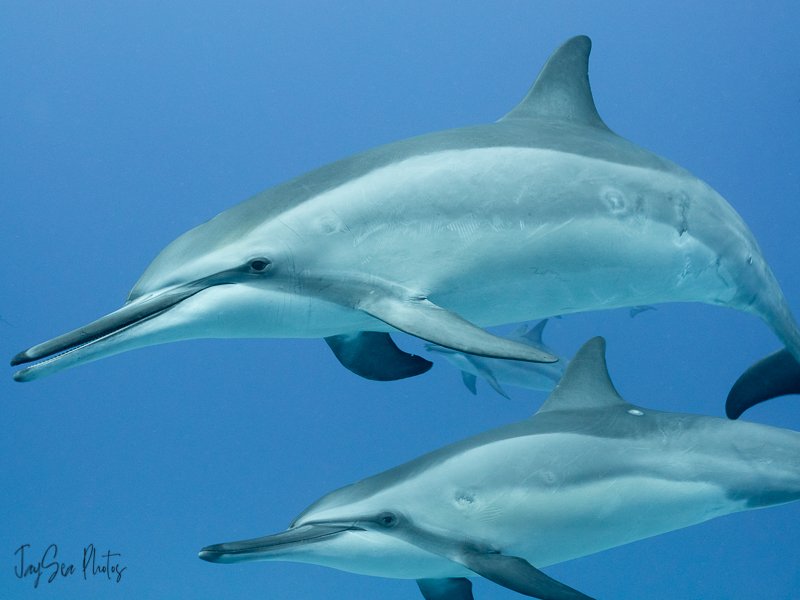

    Here are two photos I took this weekend one day apart at the same dive site fully zoomed in at f6.3 and 1/160.  I lightly white balanced these in LR, otherwise they’re pure in all their rough glory.
    Day 1:  The group of 7 dolphins were taken with the 14-42 at 42mm with the WWL at 8:30AM f6.3 1/160th ISO 640 (auto-iso)

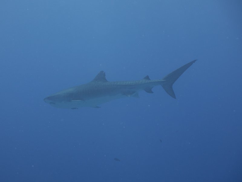

    Day 2:  The tiger was taken with the 12-40 PRO zoomed to 40mm at noon, so more light.  f6.3 1/160th ISO 160 (auto-iso)P2280200.jpg.1aaed30b7a21b3caf63165fc75528d3b.jpg

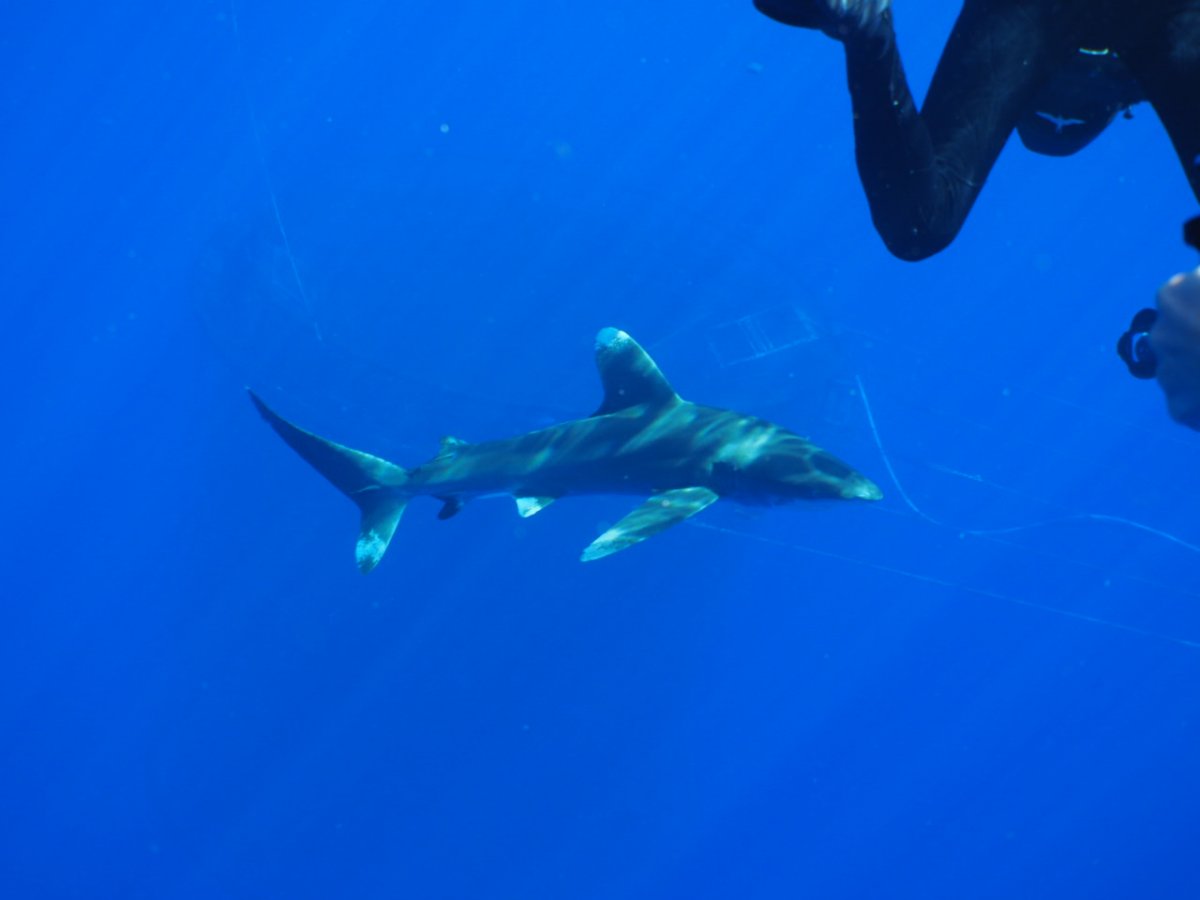

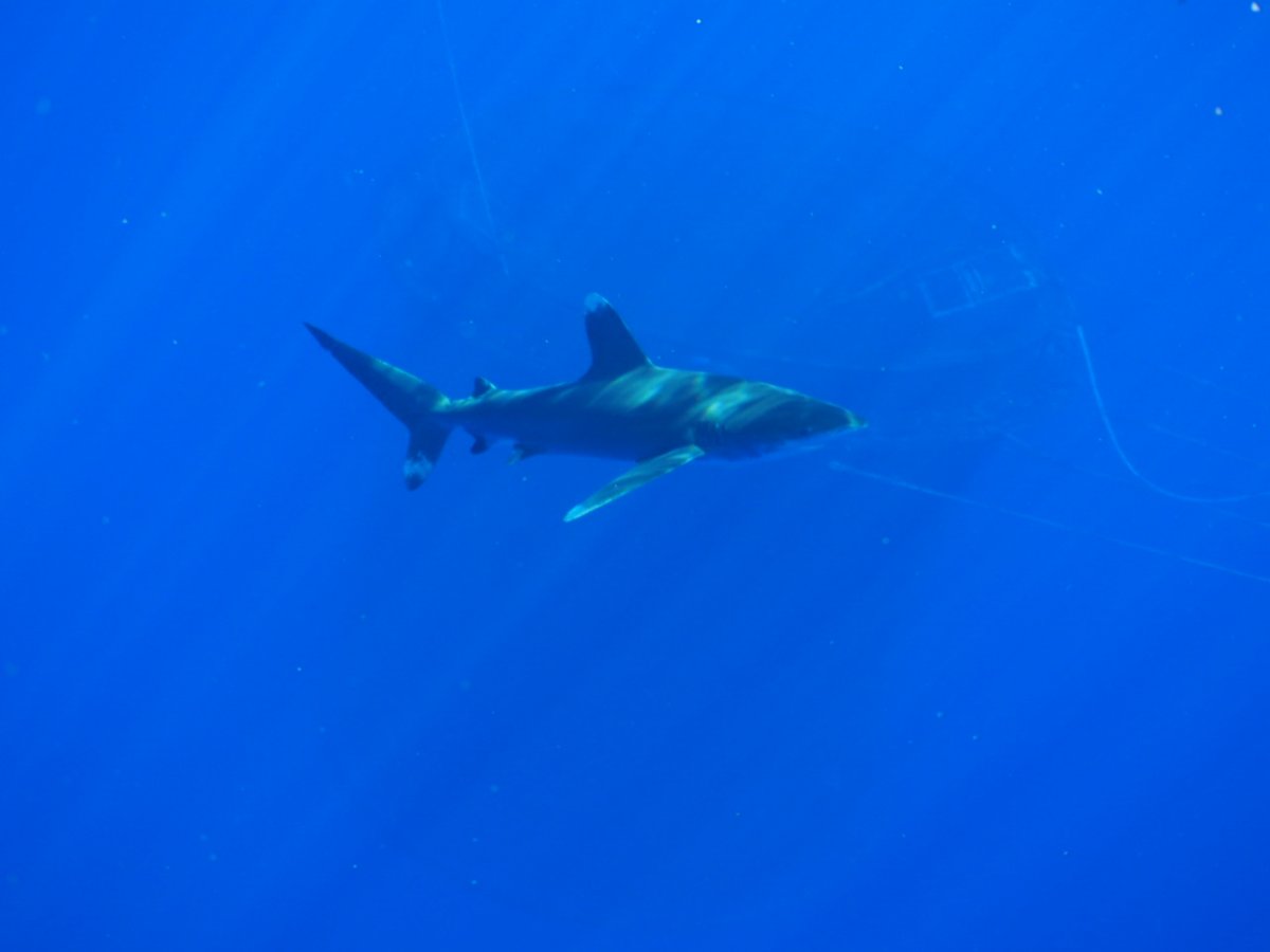

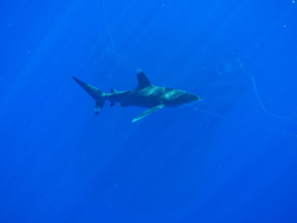

  4. Here are a few more examples of the 14-42 + WWL zoomed in at 42mm on a sunny day offshore.  f5.6 1/250 ISO 400.  Not quite sharp enough.
    P2210020.thumb.JPG.ab81a03702c6ba616676feb36266a99d.JPGP2210019.thumb.JPG.0867b65fb5bee957cd5604f6321b161e.JPG
  5. I don't have the 14-42 lens so can't comment on its snappiness or otherwise, the 12-40 is very good and it's getting 2 stops more light onto the sensor.  There's several components to good AF the speed of the lens getting more light to the AF sensor is one, then there's the speed and precision of the AF motor and how well the characteristics of the two are matched up.
    To me this is the one downside of the WWL concept, the kit lenses are often slow and don't have the latest or best AF equipment onboard.
    Looking at the pics and their histogram, the contrast is quite low which probably had some role in the AF issues you are seeing.   This I think quite typical for distant subjects.  I assume you're saying 12-40 had no problem with the tiger shark  and if it is zoomed right in would be well off I would guess.
    Out of interest which particular 14-42 do you have?  They may not all be the same and might be a question worth asking regarding performance at the long end?
    BTW, you seem to have some reflections going in the last two shots or is that something in the background?
    BTW2 - I use the 170mm Zen dome and don't experience floatiness, I find it nice and compact for my purposes.  I'm guessing you have the 7"acrylic dome which I've seen and is significantly bulkier than mine.
  6. Acrylic domes are generally very floaty, so moving to a glass dome will increase weight for travelling but improve handling underwater significantly.

    Yes, the 12-40 had no trouble focusing on the tiger and the sharpness of the photo is better.
    I have the Olympus M.Zuiko Digital 14-42mm f/3.5-5.6 II R.  I checked with Nauticam and asked if they recommended one of the 14-42's over the others.  They mentioned it was 'splitting hairs' between the different offerings.  Since I already had the Oly, I just used that.  @Intercepter121 mentioned that Panasonic Lumix G Vario 14-42mm F3.5-5.6 II ASPH Mega OIS is the best he has used.  How much better than the Oly?  I don't know.
    Reflections in the last two shots are actually a submerged fish pen (attracts the Oceanics).

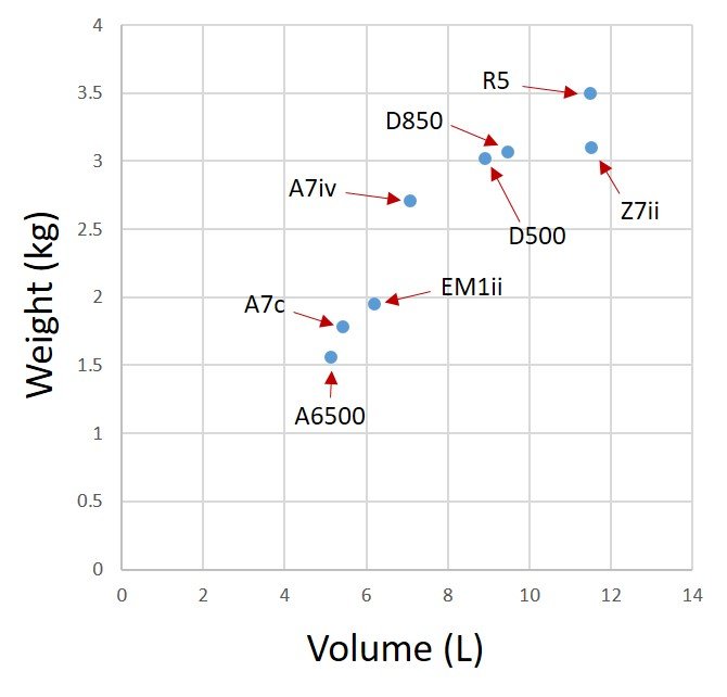

  11. 5 hours ago, caolino said:
    do you have any details comparison in term of size and weight including pictures? I'm very curious about it
    The size and weight of the two housings is very similar (based on specs from the Nauticam website).  I'm assuming the cameras, lenses and ports would be similar in size and weight.  WWL-1B is 3lbs.
    Olympus
    Weight 1.95kg
    Dimensions 305mm (W) × 175mm (H) × 116mm (D)
    Sony
    Dimensions 307mm (W) x 172mm (H) x 103mm(D)
    Weight (in air) 1.78kg

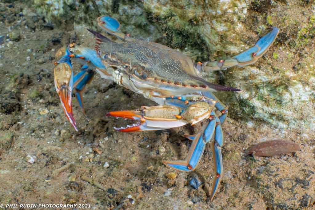

    This is a no brainer to me, first I used the Olympus line for years including the EM-1 II and also the WWL-1with EM1 II you can find those reviews in the back issues at uwpmag.com. I am also probably the only one on this site that has used the Sony A7C, FE 28-60mm zoom and WWL-1.
    The only real question here is do I want to stay with a smaller format sensor or go to full frame with its added issues.
    Bottom line is that the A7C is faster, smaller and has noticeably better image quality as most FF cameras do when compared to sub-full-frame. I have heard all the arguments for both formats but the bottom line is that if your top priorities are speed and IQ the Sony A7C is just better.
    While many DSLR users will argue that size should not be a large issue when selecting a U/W camera I believe they are forgetting why many of the older ones left film cameras in large housings and went to the Nikonos RS system. My spell check does not even recognize the word Nikonos but I would venture to say that more than half of the published U/W photo pro's were using the RS system before they went to digital. I would also bet that one of the top reasons for using the Nikonos RS  SLR camera body and lenses was reduced the size and weight of the system. I would guess the top reason was the quality of the water contact optics which won out over AF speed because they were more than a bit slow.

  15. I don't think I could be more clear, the A7C is faster and has better image quality across the entire range. I have owned the 12-40 and the 14-42 power zoom with WWL-1 has better image quality than the 12-40 even if you used it behind a 230mm dome port.
    Sony FE 28-60mm, at 28mm end (fish) and 60mm end of the zoom range (crab) with WWL-1.
    You were clear.  Thank you :)
    Olympus
    Weight 1.95kg
    Sony
    I am also considering different systems at the moment and fabricated the graphic below, that illustrates how tiny the housing of this new FF is in comparison to other common cameras. The graph shows the volume of the housing (of a brick with the dimensions given on the Nauticam homepage) vs. its weight in air. While weight and volume of the housing for Nikon, Canon and Olympus go (roughly) inversely with the crop factor, Sony housings do not obey this rule... :rolleyes:
    Wolfgang
    Edited by Architeuthis
  18. Wow, interesting, Wolfgang! Could you add the D500 to that?
    Voila - I have edited the posting above. We must not forget, however, that these are the sheer housings and the optics adds. But in case the new Sony lens really provides excellent IQ with WWL-1, this may be indeed a very interesting configuration...
    Wicked! Many thanks indeed, Wolfgang
