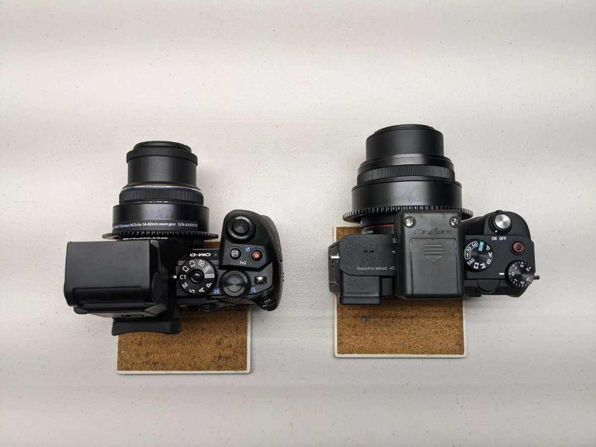

  13. I've had the Sony kit for a few weeks now, and have been jotting down a few notes.
    This is not an equipment review but rather my experience moving from the Olympus OM-D E-M1 II in a Nauticam housing  with dedicated lenses and ports/domes to the Sony A7C in a Nauticam housing with the 28-60mm kit lens, WWL-1B and CMC-1.
    Here are a couple of photos of the Olympus on the left and Sony on the right.  The Sony has a Nauticam flash trigger mounted on the hotshoe.

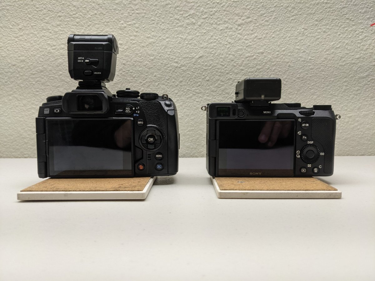

  14. Camera Body Notes:
    The Olympus feels less 'plastic-y' and more ergonometric for land use than the Sony.  I only plan to use the Sony underwater, so this isn't important to me.
    Sony EVF is on the far left.  I frame with my right eye, so took a bit of getting used to, but now i don't notice it.
    Sony EVF is smaller than the Olympus.  Almost too small to track small fish darting around in a larger frame.  Macro I can still manage viewing focus, just barely.
    You can’t turn off fill flash on the Sony in Manual mode.  This means you need to turn off the strobes when shooting with ambient light.  I shoot with 2 custom dials set up.  One for flash.  One for ambient.  The Olympus ambient dial has flash turned off, so I can leave my strobes on.  The Sony ambient custom dial doesn’t allow this, so you need to actually turn your strobes off to ensure they don’t fire when shooting ambient.  Maybe I haven't figured this one out yet.  If any Sony users have tips, please share.
    Sony 28-60 doesn’t stop when you zoom all the way out, so you end up retracting the lens if you keep going, which causes a warning sign to appear on the screen.  I did this a few times on the first couple of dives while in the housing, but have gotten used to it now.
    Sony does not come with a battery charger.  Charging is via USB-C cable (which is included).
    Sony doesn’t charge with the USB-C cable if camera is ‘On’.  I’ve made this mistake a couple of times, went to load my camera, but had to wait to charge it again in ‘Off’ position.  Again, if any Sony users have tips, please share.

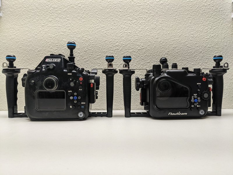

  17. Here are a few photos comparing the size of the Nauticam housings.  Olympus on the left.  Sony on the right.

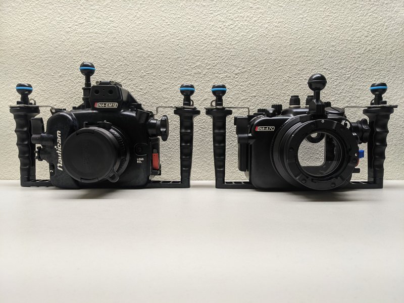

  18. Nauticam Housing Notes for the Sony:
    Sony on/off button on housing is more robust than the Olympus, and you don’t need to lift the housing switch up before removing the camera like you do the Olympus.
    Sony Nauticam housing tray does not overlap the camera battery cover, so you never need to remove it.  Olympus tray has to be removed from the camera every time you change the battery.
    Sony is slightly easier to load tray into the housing, as it does not sit as deep in.
    The Olympus housing has a top ball mounting hole, which is where I had my focus light mounted.  The Sony housing does not have this mounting hole, so I moved my focus light ball to the plastic hot-shoe mount on the lens port, which isn’t quite as rigid.
    Sony housing has more robust fiber optic ports on the housing, but you have to purchase Nauticam Optical Fiber Connectors ($27) to use standard fiber optic cables.  Olympus housing does not require this.
    The Sony nauticam flash trigger has an on/off switch that must be turned on with the housing open.  The Olympus doesn’t require this when using the kit flash to fire strobes.  I used to prepare my camera the night before for early morning dives, including turning on the leak detector and vacuum pumping.  The green leak detection led light doesn’t seem to draw much power, as I haven’t noticed substantial battery drain doing this.  I’m not sure I can do this now, as the nauticam flash trigger will be on all night inside the housing (it has a blinking green light to signal that it is ‘on’).  Will have to test it out.  Anyone have experience leaving the Nauticam flash trigger on overnight?
    Most pictures you see of the Nauticam with 28-60 lens show the focus knob installed on the port.  This is optional, so I left it off until I decide whether a manual focus gear is required.
