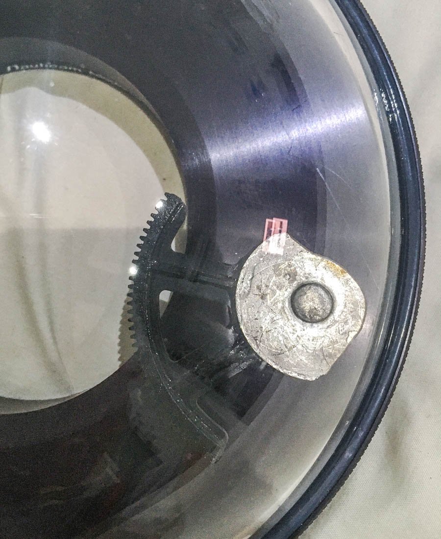

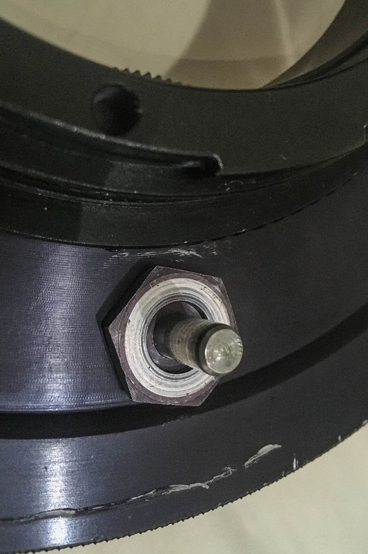

    It's acrylic in good condition. I use it on Nauticam with an Aquatica to Nauticam adapter. I added a manual focus control to the dome so I could manually focus the Tokina 10-17 on a Nikon Z50. The FTZ adapter doesn't support screw-focus lenses. For over/under manual focus is fine, since you focus on the underwater bit and let the depth of focus include the topside part. If you are using a lens with AF I can put a blank-plug is the hole for the focus control if you prefer. New price with dome shade is US$ 530. I can sell for US$ 300. I did a comparison test between this dome and the Nauticam 8.5 acrylic dome and there's no quality difference that I can detect.
