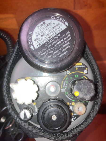

  8. If you never want the pin out, you can solve the issue in a permanent way.
    1. Remove the magnet button
    2. Place a magnet cilinder in place
    3. Put a screw over the magnet
    This is the way I have solved the problems with the magnet of the button that got corroded and was not activating properly.
    You need to find a magnet cylinder of the right size and the screw of the right size also. You need to be careful because magnet and screw too big might result in damage of the strobe housing.
    I will look for the screw parameters to post it here.

  12. The Z240 switch's screw thread is 1 x 7 mm and the hole is 16 mm deep. A round head Philips screw of about 7 mm length should do the job of replacing the switch button.
    My Z240's switch turned much too easily. To unscrew it required pliers. After I screwed it back on, it is hard to turn and now jams either open or shut, so the problem of its turning easily between locked/unlocked is solved, I hope.
    Edited by Kraken de Mabini
