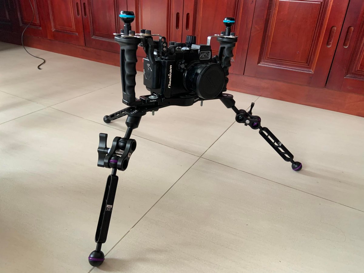

  2. Hello again everyone - as an update, I got to test the quadripod a couple of days ago, and it works great!
    The arms held fine, no rotation, and I was actually surprised by the flexibility offered by the clamped leg system, which really allows to make up for positioning uneven terrain! More flexible than I though, as I didn't think it was possible to play with clamp angles as much and still hold the rig in position.
    Otherwise as predicted, the compact housing with the flexitray, a small video light, and the arms clamps + leg system was negative enough to be stable, even on a relatively choppy day with respectable surge.

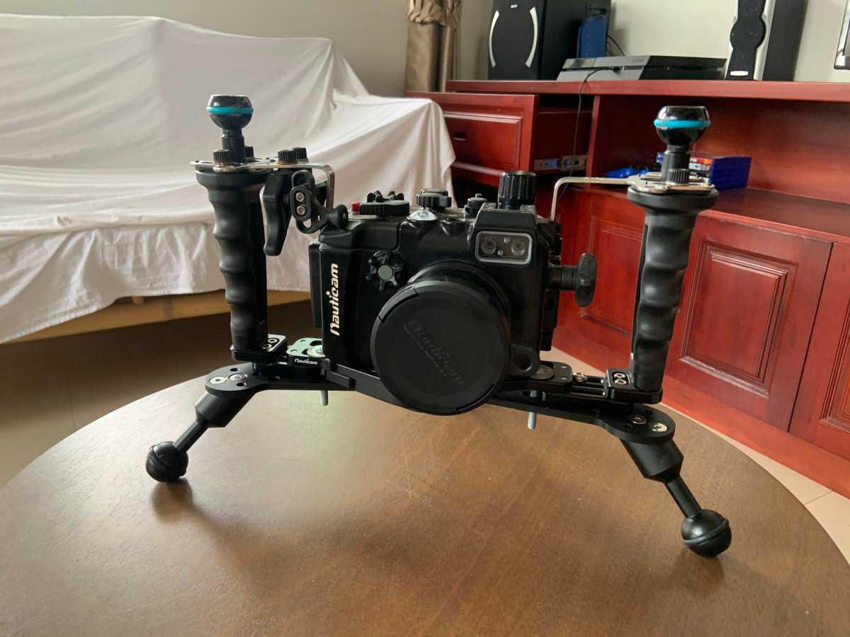

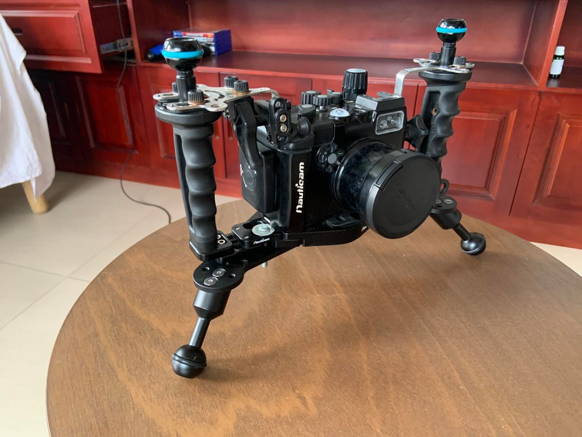

  5. Tripod tray ordered from Aliexpress arrived yesterday. (https://www.aliexpress.com/item/1005001793864931.html?spm=a2g0s.9042311.0.0.43284c4dv3RhVP)
    Not too bad really, build quality seems perfectly fine. Although hard to go wrong when it's such a simple piece of gear
    Had to use my own bolts/washers/nuts to secure it to my Panasonic lx-15 Nauticam Hosing, rather than the ones provided but that's not a big deal.
    Perhaps one potential issue will be the 45 degree angle of the 1" ball arm connectors limiting how tight you can position the camera rig to the substrate. However, I'll need to give it test to confirm or deny this.
    Looking forward to getting a chance to use this in the coming weeks.
    Cheers!
    Edited by Mattg256
  6. It seems perfect to me.
    45° angle is perfect. Keep in mind that my Nauticam GH5 default ball joints for tripod use are at 0° (horizontal) and you have to tight it strong.
    In your config I like that ball joints are so long that you have a mini tripod already. That alone would cover 80% of my typical filming situations. Expecially close details not real macro.
    Cheers!
    Looks great!
    There's quite a lot you can do with a Flexitray after all - too bad the standard tray spacing isn't really thought out for extra attachements as is, but a little DIY makes it much more... flexible!
