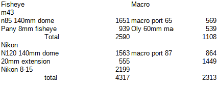

    You may find you are happy with a compact to just snap photos and while you can add  wet lenses to go wider or do macro there are limitations and it will depend on how patient you are to keep working around them.  The issue is the core range of the 1"compact is a 24-70 lens that really doesn't focus that close - so the bare camera takes reef snaps and is fine for photographing larger fish etc, probably weedies as well.
    To go wider once you pick the right camera is relatively easy,  though best wet wide lenses are quite pricey (Nauticam WWL) and large and heavy and not that practical to swap and change during a dive as you need somewhere to put them.  Many people revert to treating them like a wide angle setup and leave them on the whole dive.  You also need to remove them when you hop in the burp them - get rid of bubbles clinging to the glass.
    For macro the lenses will give you a very limited working range for example the RX100 V with a CMC-2 only focuses between 80 and 124 mm from the subject  and fills the frame with a 48 x 32mm subject on a Nauticam housing.  Outside this range nothing is in focus.  It can be frustrating to position the camera properly every time.
    Strobes are one item you can keep as you upgrade if you buy a good set first up.
    Unless you are printing your images large or specail cases that require low light performance you will be hard pressed to tell the difference between a 1"compact and a full frame DSLR or mirrorless setup.  What you do get by stepping up to an interchangable lens setup is usability, for example your macro lens focuses all the way from 1m away (or further - but you don't want too much water in the way) to life size making framing a lot easier - generally the AF is better and importantly you can use fisheye lenses as well  for wide angle work.  The costs between a m43 and a full frame system can be significant, here's some examples using new prices for Nauticam components and new prices from digidirect for lenses:
    It soon adds up to a significant difference as you go through the components.   I use an olympus EM-1 MkII setup and it's good enough, kind of a sweet spot, the the image quality is better than a compact and can compete with APS-C systems on quality while using the cheaper mirrorless lenses, which are generally very sharp.  I just don't have the uses for my photos that needs more quality.  I would suggest you go through pricing the various options to see what you are up against.  Remember when upgrading most items will only net you 50-60% of the new price.

    I see, there is definitely a big jump with the quotes. Do you think its possible to learn on a mirrorless/ would it be worthwhile to start out on? Or is it too big of a jump and would realistically just turn out to be overwhelming.
    I don't see a great deal of difference between setting up a compact vs an interchangeable lens camera.  You'll still want to shoot both on manual and there are less kludges to deal with things like for example no manual flash mode on the compacts.
    The ability to shoot macro, wide angle and everything else on the one dive is less, but it is generally regarded as better to decide ahead of time what you are looking for on a dive so you are better able to find subjects and the whole setup of the shot rather than chopping and changing between different subjects and getting average snaps of them everything rather than great shots of your selected subjects.  It's like getting your head into a macro space or a wide angle space.  Macro for example often requires a lot of searching to find well camouflages interesting subjects, while the approach to find wide angle subjects might be quite different.
    We have been talking about wet lenses to extend the range of the compact fixed lens and you can do it, but unless you shell out for the very expensive new generation of wide lenses you often are not getting that wide with your shots and as I explained before, macro is a bit limiting due to the characteristics of the diopters.  Shooting with a proper macro lens is lot simpler in my mind.
