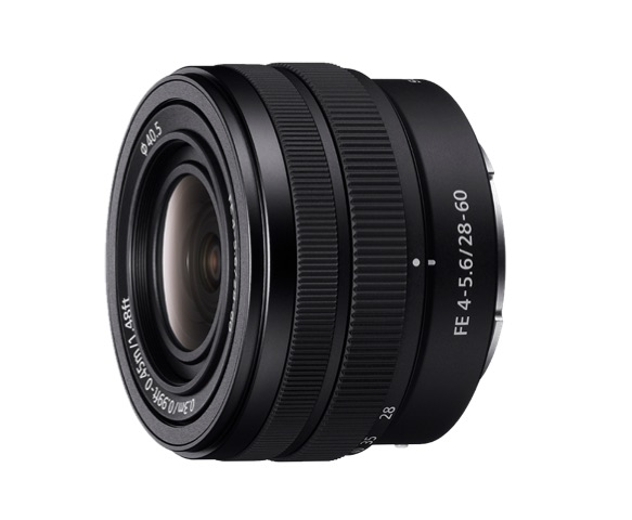

    The Sony FE 28-60 has a filter diameter of 40.5mm, but the glass front element seems to have a wider diameter than on the RF-S18-45.
