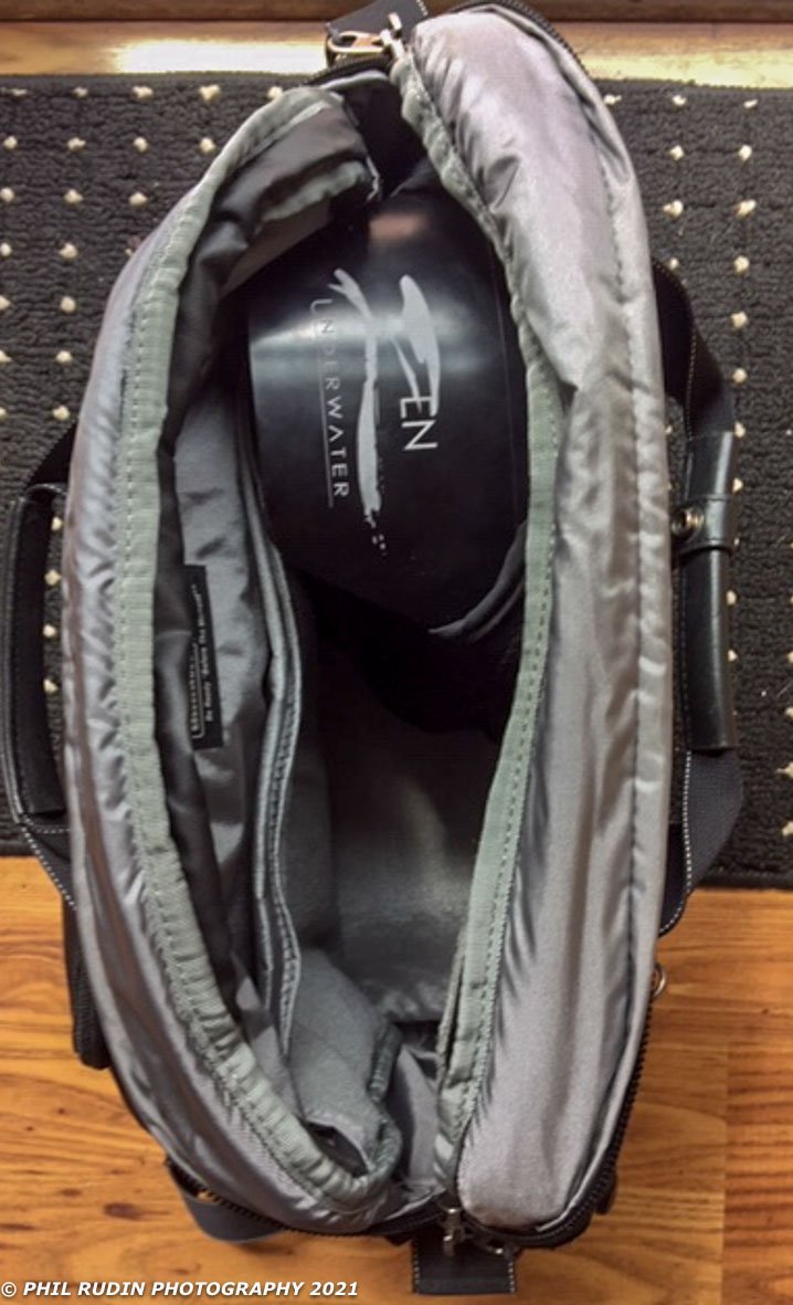

    I have not settled on either system for travel, I chose the one I think will work best for me during my travels or in some cases take both. I have attached a photo of my carry-on shoulder bag with the 230mm port standing on its side with room to spare for the WWL-1B. I find that the shoulder bag is least likely to be weighted when checking in for international travel so a good place to put heavy items like lenses and ports.

    I have used the 14mm F/1.8, 12-24mm F/2.8 and 12-24mm F/4 all behind the Zen 230mm Optical glass dome port. The reason for buying the Zen over the Nauticam has nothing to do with overall quality but with laziness. Because I use the port with the Canon 8-15mm fisheye the port shade/blades need to be removed for the 8mm circular fisheye or it will vignette. It is easier too remove the Zen blades than the Nauticam shade.
    Regarding 12-24 F/2.8 and 14mm F1.8 I use both a lot and do a lot of split images with both. The issue for you is how big a difference you will see on your 12MP S III v. my A1 (50MP) and A7R IV (61MP). I think with 12MP's the gap with 12-24 F/4 and Rokinon 14mm F/2.8 (also reviewed) would be closer than with 50MP and up. If I had to pick one of your two choices it would be the 14mm F/1.8 because of size, weight, filter system size for landscapes and of course cost V. 12-24 F/2.8.
    Regarding cost the Nauticam 230mm fisheye II port after recent price increases is $2439.00, 55mm port extension for 12-24 2.8 is $441.00, zoom gear 244.00 and lens is $3000.00, total about $6124.00. Buy comparison The 28-60 is $500.000 (without A7C kit discount) WACP is $5159.00, zoom gear is $253.00 and no port extension with the N100 to N120 35.5 port adapter II, total around $5912.00. With the WWL-1B, N-100 flat port 45, zoom gear $253.00, lens $500.00 and bayonet mount $103.00 price drops too around $2733.00.
    Thanks for the detailed reply. I’ll probably get the two setups (Sony FE 12-24mm F/2.8 GM with the 230mm port and the Sony FE 28-60mm F/4-5.6 to work with my WWL-1 and CMC-1), and use an old shoulder bag for the 230mm port like you do; never imagine I’d repurpose the bag this way!
