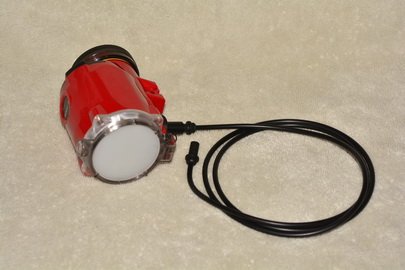

    a) Single fiber Toslink cable, about $1 to $2 per meter, outer diameter of 2.2 mm or 4 mm, is sold by Amazon and eBay (2). I have made several 2 mm, 3 mm and 4 mm Toslink cables and all consistently flashed the strobes. The connectors (plugs) are secured to the cable by pressure, or with plumbers ABS cement (Fig 1).

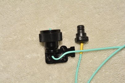

    Sources: Amazon sells 7mm connectors as Uxcell 7 mm o.d. strain relief protectors. Fun-In Photography and DiverVision in Taiwan, Backscatter and Reef Photo in the US, sell rubber and L-shaped connectors. The rubber connectors hold one or two cables, the L-shaped connectors hold the cable in a curved, 6 mm radius, conduit (Fig. 2).

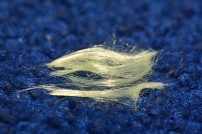

    c) Fiber patch cable: I built and tested, but do not recommend, a multi- glass fiber cable (also known as ‘fiber patch cable’) (Fig. 2), sold by Amazon or Vandesail, as it is difficult to cut and the multi fibers bunch up at the cut end (Fig. 3). When tested, it transmitted light unreliably as it flashed a new Inon S2000 strobe, but not an older D2000 strobe.
