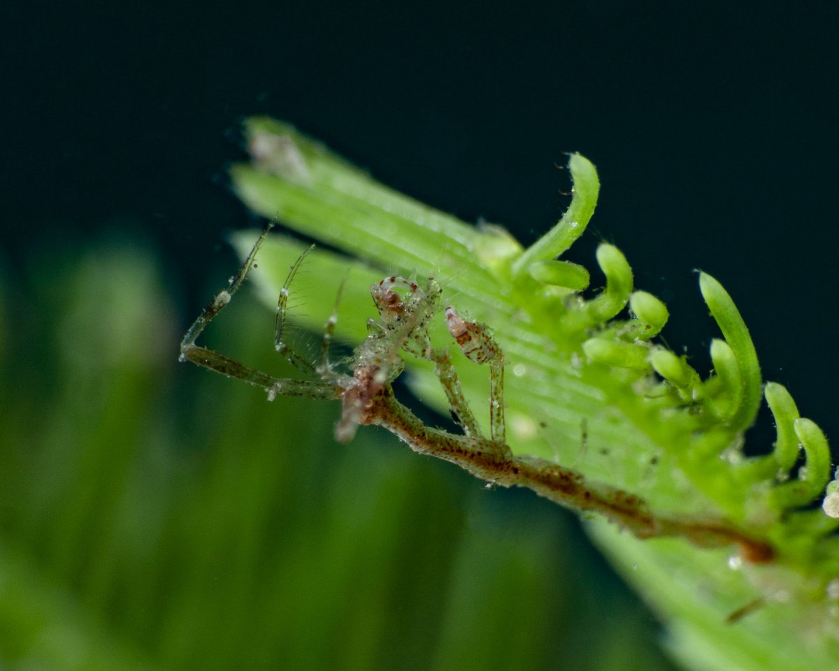

  7. I use both the CMC-2 and SMC-1 on the Sony 90 mounted to an a6500. since its new (to me) I have yet to really dig into the SMC for 1-5mm subjects, but I have had great success with 4-20 mm subjects using the CMC-2 and 90mm. Autofocus is (in my opinion) relatively quick using the CMC-2. I have found neither to be particularly unwieldly. The Skeleton shrimp below is about as small as I would target with the 90/cmc-2 combo.
