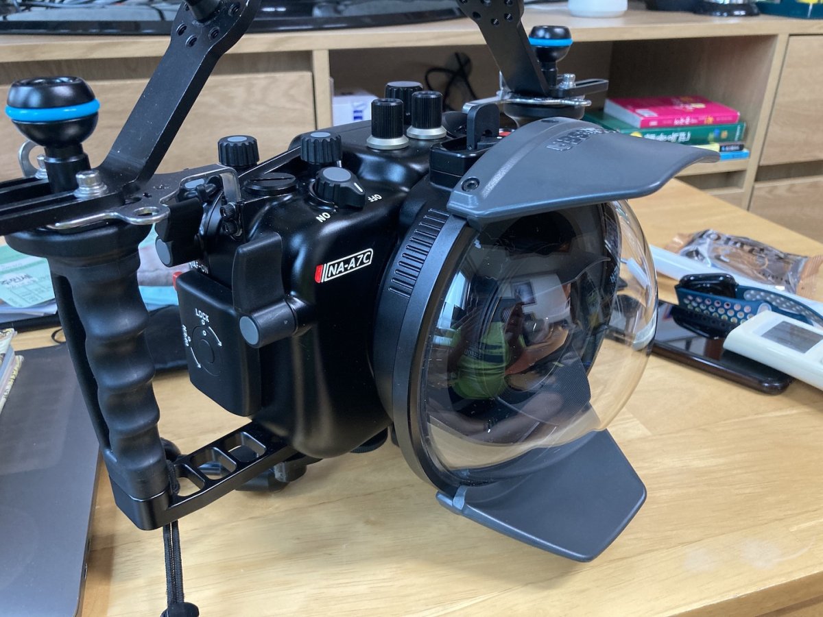

  10. Hello
    I am a user of the sony a7c Camera Nauticam housing.
    My wide-angle lens setting is Sigma AF 15mm F2.8 EX DG Fisheye lens with an MC-11 adapter.
    This setting is an alternative to so few Sony e-mount wide-angle lenses.
    Various tests were conducted to use the system charts that the Nauticam does not have, and I am currently using the SEA&SEA NX Dome for weight optimization.
