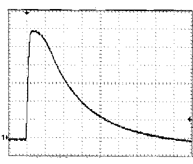

    No. While fast shutter speeds cut out some flash light, they cut out the ambient light more. This was posted by @Pavel Kolpakov a few years ago:
    X-axis is time, Y-axis is light intensity. As you can see, it peaks quickly, then gradually loses intensity. As you reduce the exposure time, you're chopping off the right side of the graph, so you're losing a little bit of strobe light, but a lot more natural light, tilting the balance in favor of the flash. This is useful primarily when you have the sun in the frame. An ND filter will affect ambient and strobe light equally, so you don't gain anything from using it - what it does let you do is slow down your exposure without touching ISO and aperture. For example, if you're shooting video in bright sunlight, and you want an open aperture for shallow depth of field, going to faster exposures will make the video look jerky - smooth video needs at least a little bit of blur for moving objects in each frame. With an ND filter, you can shoot ISO 100, f/2.8 and 1/60s without worrying about overexposure. Likewise, if you're doing a long-exposure photo like a landscape with flowing water, where you may want several seconds of exposure in order to smooth out the water movement - even the smallest available aperture might not be enough to let you expose as long as you want without blowing out the image, and an ND filter helps there.

    You are right, but only if the flash is adjusted already to its maximum power and in the case that the flash duration is much shorter as the exposure.
    In real life, with flash durations ranging between 3 - 25ms at full power (as described in the post you are citing), the fastest sync. speeds that make sense would be between 1/330 and 1/40. I admit that small improvements, depending on the type of flash used, maybe up to 1/500 ,would make sense, but I believe that in real life a digital ND filter (in case it can be used together with flash?) does not make much difference...
    What are the situations were one would desire to have a high sync. speed?
    #1.: Darkening of background in Macro: normally the flash is operated at low power in this situation. The effect of ND filter can easily be compensated by turning the flash to more power (the flash normally does not lit the background). I conclude ND filter has essentially same effect as increase in shutter speed...
    #2.: Sun in WA photography, flash is used to expose the foreground. High flash speed needed to avoid overexposure of the sun: Only when flash duration is short enough, an increase of shutter speed over 1/250 makes sense. In case a flash is used that requires long shutter speed as 1/40, low ISO and small aperture may not be enough to avoid sun overexposure and digital ND filter will be a benefit. I conclude that flash sync. speed up to 1/400 makes sense with standard flash, e.g. Z330, but that is it. ND filter together with more powerful strobes also does the job...
