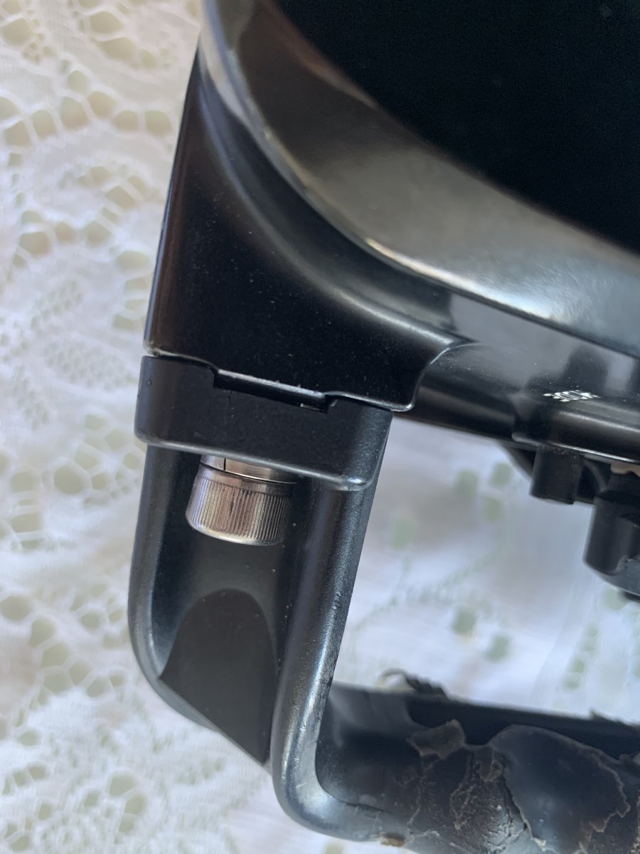

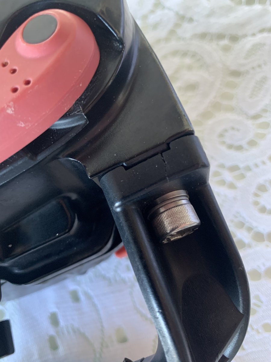

  1. Hi just enquiring if anyone has had the same issue with cracked handles.
    The handles on my DSLR Nauticam housing have cracks on both handles at the base where the screw attaches to housing. Is this a common issue?
    I would hate it to snap while I have my 230 glass dome attached!

    I assume you have the upper stainless plates installed - they were developed as a response to issues with the handles if I recall correctly.
  3. Yes I do they are attached to the housing as well .
  4. Not good. I would talk with the dealer and ask for replacement handles.  If that fails, you might consider writing the president of Nauticam, send him several photos and ask for replacements, they should be free or low cost.  And meanwhile, I would not dive with this housing, too risky.

  6. If you look at the images of the current D500 housing on Nauticam's webpage  which looks quite similar to your housing handles they appear to be using bolts with a larger head.  Your housing is using standard socket head cap screws.  The bigger screw heads will spread out the load more so than the cap screws will.  The change is possibly a response to failures in the past?
    I also see one of your photos I can see a shaped gasket under the handle taking up the space in the groove on the mating face of the handle, It is not visible on the other side - is it installed.  This may also be assisting in spreading the load.
  7. Thanks Chris I’ll look at how the new handles are designed, just waiting to hear from my local Nauticam dealer in regards to warranty if any.
