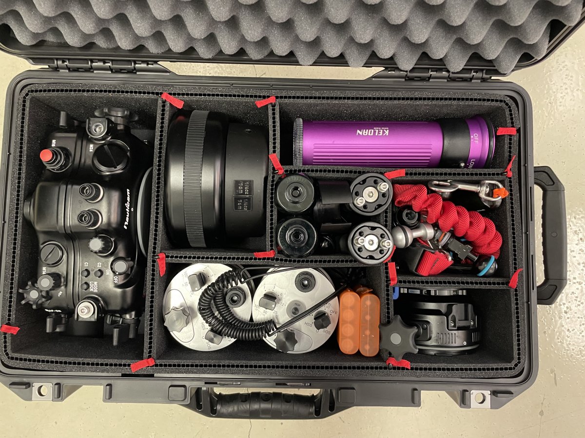

  6. Hey Brett,
    1) I have a Prism2, so it's a bit deeper and thus the Pelican Air 1637 case. A buddy carries his rEvo onboard with a rain cover over it, his wife gives him a huge amount of crap " why don't you just check that thing!" ;-)
    2) Pelican Air 1535. I still need to put a couple floats in the dive gear bag (Sthalsac) and I put camera itself in computer bag.
    3) Sony A7C with the WWL-1B. This case is just deep enough so I don't need to take off the handle ball mounts. The blue bag contains all the clamps, etc. I have a CMC-2 diopter that fits nicely in the spot with the port. Total weight is about 24 lbs.

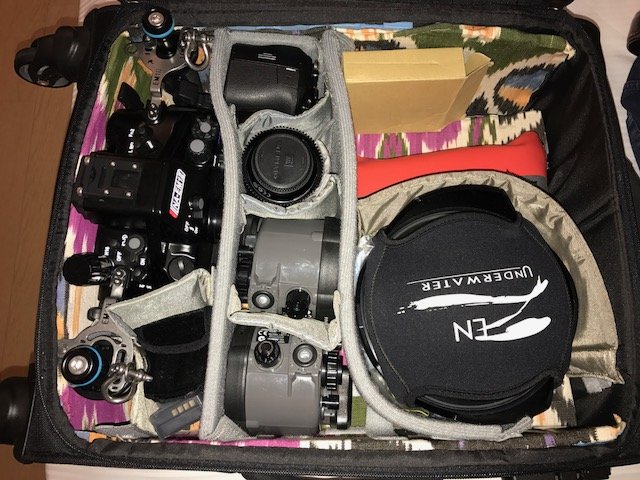

    Hi Brett,
    this is the bag - the housing is an Olympus EM-1 MkII so a bit smaller than the Nauti A7IV you have.It's lined with closed cell foam that I glued some fabric on and velcroed in place.  It's a regulation size domestic spinner from Samsonite - so completely anoymous.  You might need to check if the housing will fit in - possibly mainly for height, the handles are inside the case so they can interfere a little, I would guess you would get everything else in - WWL is about the size of the 170mm dome, there's some space above the dome for video lights, not sure how big they would be.  The dividers are from my photo back pack.
    The spinner itself is a samsonite, nothing special.

    My housing is right on 7"high at the top of the balls.  This is one area where you have a little more flexibility with a standard carry on roller bag, many airlines allow carry ons that are 9" high.  Of course you want to be sure you are able to carry them on, not really suited for checked baggage
    There's endless variety among them with a wide range of qualities.  My samsonite one was not super expensive but the construction is a little on the light side and the bag's handle collapses inside the bag which interferes with packing a little. The two wheel roller bags give you more internal space as the spinner wheels are counted in the bag height dimension.  They stick out about 2".5: on spinners but are recessed on the two wheel style bags.

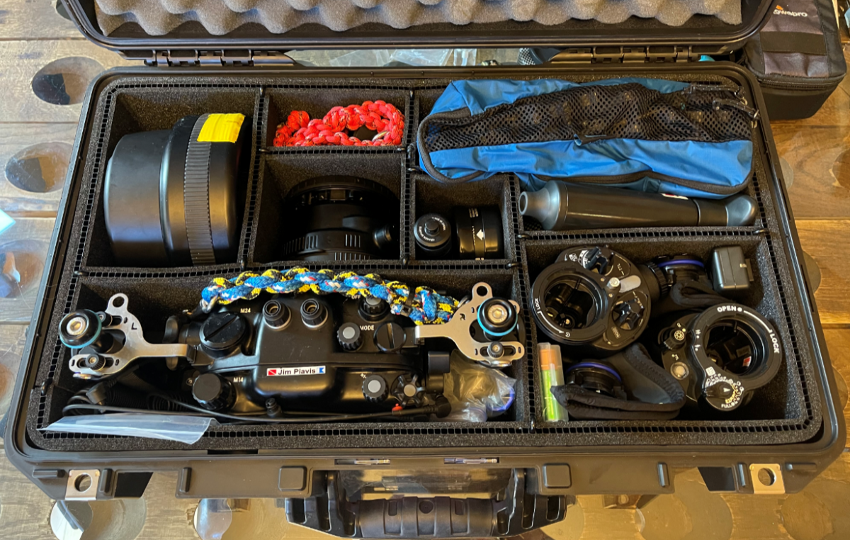

  11. I wanted to give a quick follow-up. I ended up getting the Pelican 1535 case so that if I have to check it, I'm not worried about anything getting damaged. I do have a Think Tank soft sided suitcase coming just to check out, but I'm probably going to return it and stick with the Pelican.
    I found it way more efficient in terms of space usage to remove the Nauticam handles and ball mounts. It only takes less than 5 minutes to re-assemble once I get to my destination.
    I'm able to fit the "old style" (larger) Nauticam housing for the a7r4, WWL-1B, N100 Flat Port 45, two Keldan 8x video lights, two Retra strobes, GoPro housing, CMC macro lens and associated batteries, etc. into the case. Below is a picture of the case with all the equipment loaded up.
    I forgot to weigh it but will do that before I leave on my next trip.
