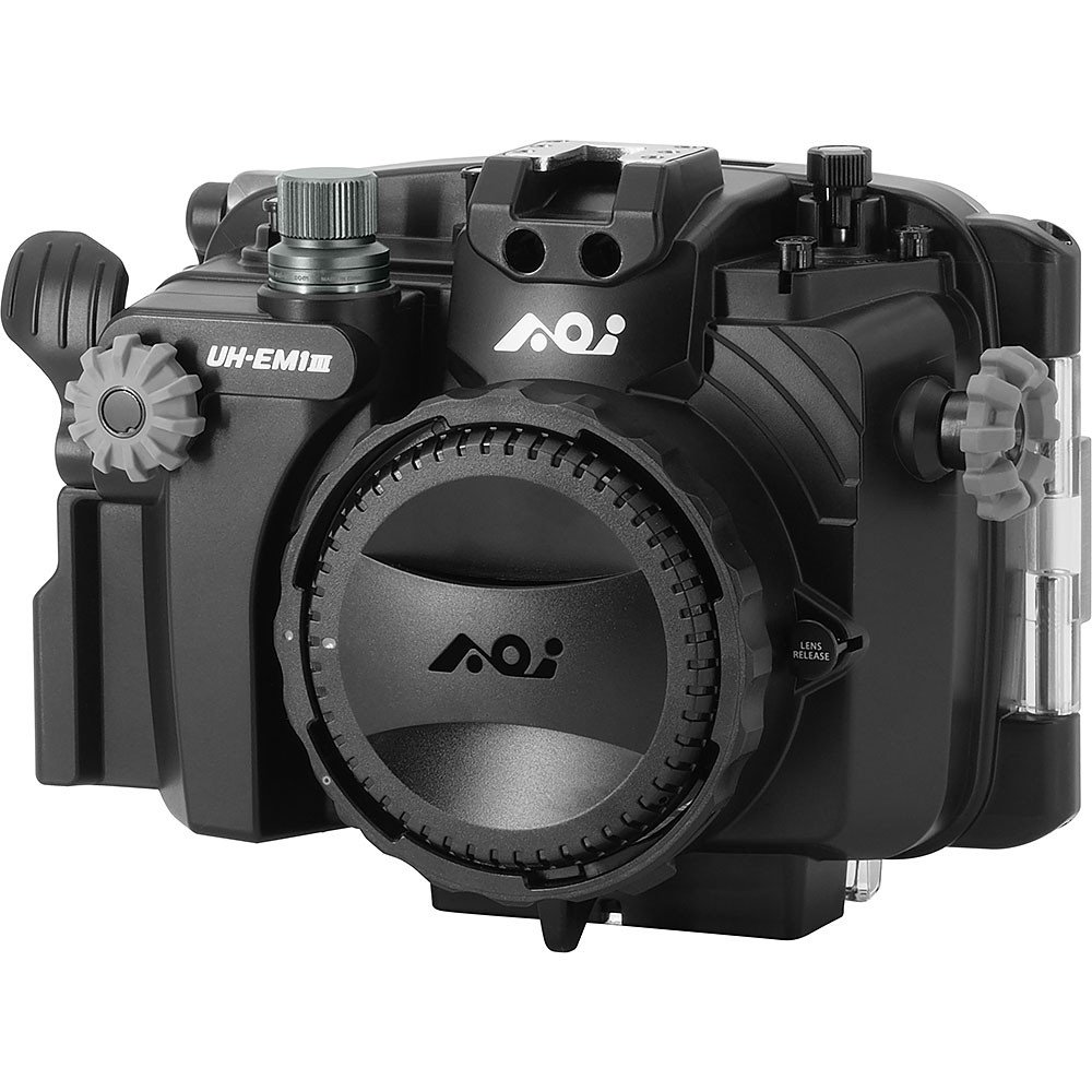

  2. I reached out to AOI to ask about the ports, and they replied:
    "The AOI UH-EM1III housing is designed to work with PEN mount port.  It can also work with OMD ports by adding an adapter for OMD port to PEN Mount Housing.  The adapter will be launched in the near future."

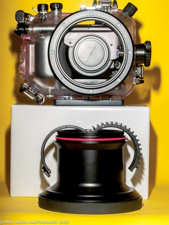

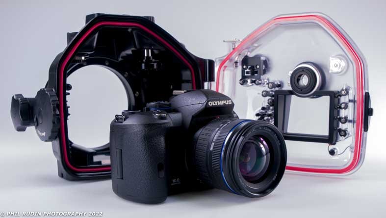

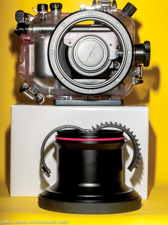

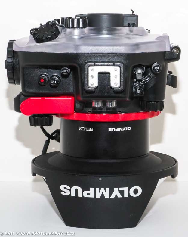

  9. Just as a side bar, the reason that the PT-EP line of housings have a larger port opening than the Pen housings is because they were originally designed to support the PT-E0 line of ports for Olympus DSLR cameras housings for cameras like the E-330 and E-520. These cameras used larger Zuiko lenses like the 7-15mm F/4 which is 119mm X 86mm compared to the M Zuiko 7-14mm f/2.8 which is 105.8 x 78.9mm. The PT-EP line has an accessory adapter to accept these threaded metal and optical glass ports.
    Images of the E-330 and E520 housings along with the dome, extension and adapter I used to review PT-EP14 for back issue #99 in uwpmag.com. The dome and extension are also the same as what I used for the 7-14 F/4 in the E330 and E520 before Olympus  mirrorless cameras arrived on the scene starting with Olympus EPL-1.

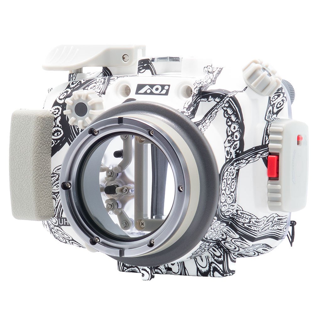

  11. Just wanted to add to this thread an announcement from AOI’s facebook page.

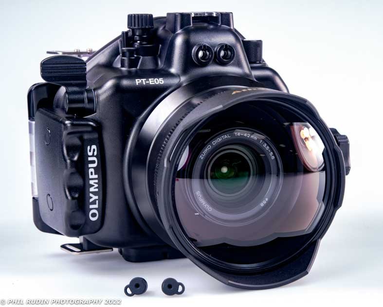

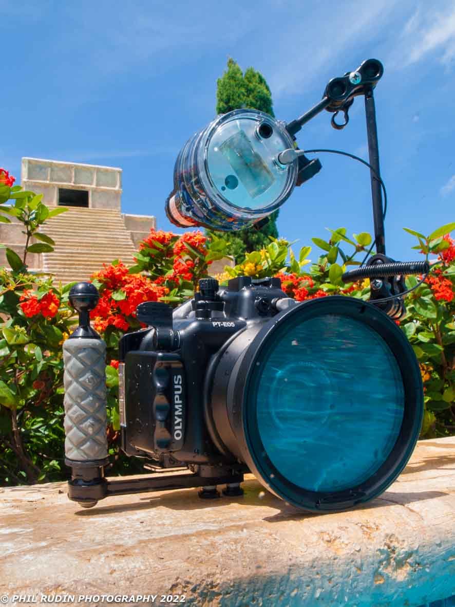

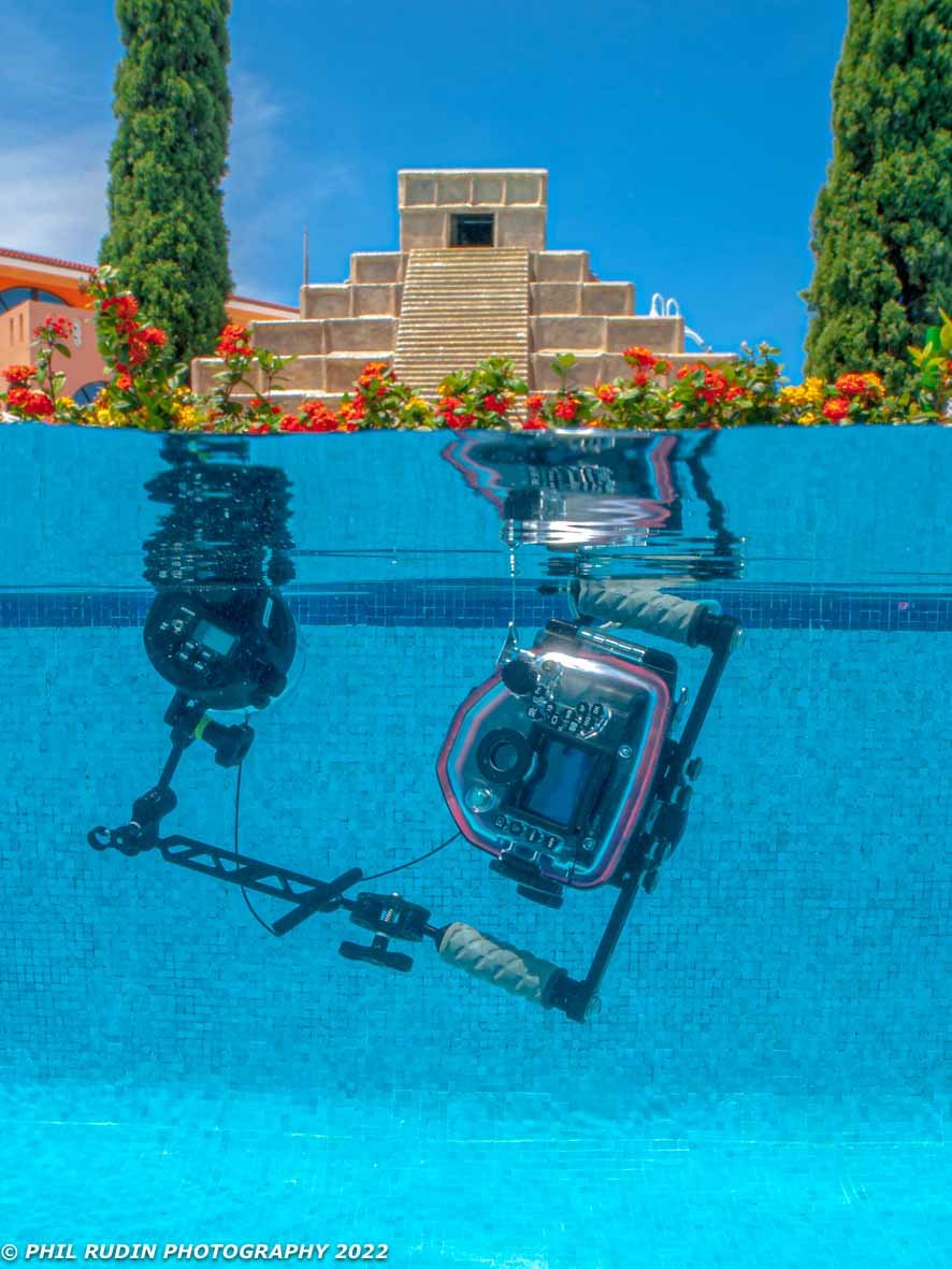

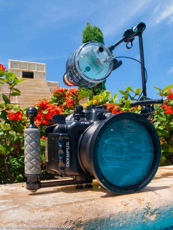

  16. The attached photos taken in 2007 are the Olympus PT-E05 housing for the Olympus E-520 and the Olympus UFL-2 strobe. This camera and strobe combination worked in RC mode, it could be set to super FP flash in TTL or manual at any shutter speed and the AOV of the flash could be zoomed in and out for wide and narrow coverage. It was like an Olympus FL-36 land flash in a very buoyant case which used two AA batteries. At the time none of the other flashes I used with the camera would work in FP or RC modes.
    Regarding the new AOI housing flash trigger for the EM-1 III and OM-1housings I think the only thing you can say with certainty regarding these features is that they will work with the newly introduced AOI UCS-Q1RC flash which has only been announced in the Japanese market at this time.

  18. Just received my housing today from Backscatter- looks pretty good from my kitchen table.  I've been asked to shoot at a training dive for our local county sheriff dive team this weekend, so we'll see how it goes.  A couple notes:
    • It's noticeably smaller and lighter than the Olympus housing for my M1mkI; it's one thing to look at dimensions online, it's another to hold it in your hand.
    • The smaller form factor has an impact on ergonomics- gripping it will be a challenge, especially in cold water with thick gloves.  The AEL button is triggered with a trigger, and it's right where your right thumb would rest.  I can tell I'll have to disable the AEL button in camera, or I'll have to grip the tray handle (not my preference).  Other than that, the control layout is actually improved over my old housing.
    • I'm greatly relieved that AOI is releasing an OMD port adapter so I can use my 170mm dome with the 12-40.  It should also work with my Panasonic 8-18.
    • I picked up an open box Inon 5.2" dome for the Olympus 8mm from another vendor- I'll shoot with that this weekend.  It's shocking how much smaller the combo is than the bigger dome.  Again, dimensions online vs in the hand (although split shots are probably not worthwhile now).
    Can't wait for this weekend!
